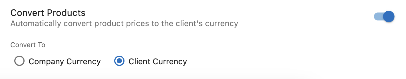

If the convert option is enabled on Settings > Product Settings the app will use the current exchange rate.

Hi @hillel ,
comvert option is enabled but still show the wrong amount
