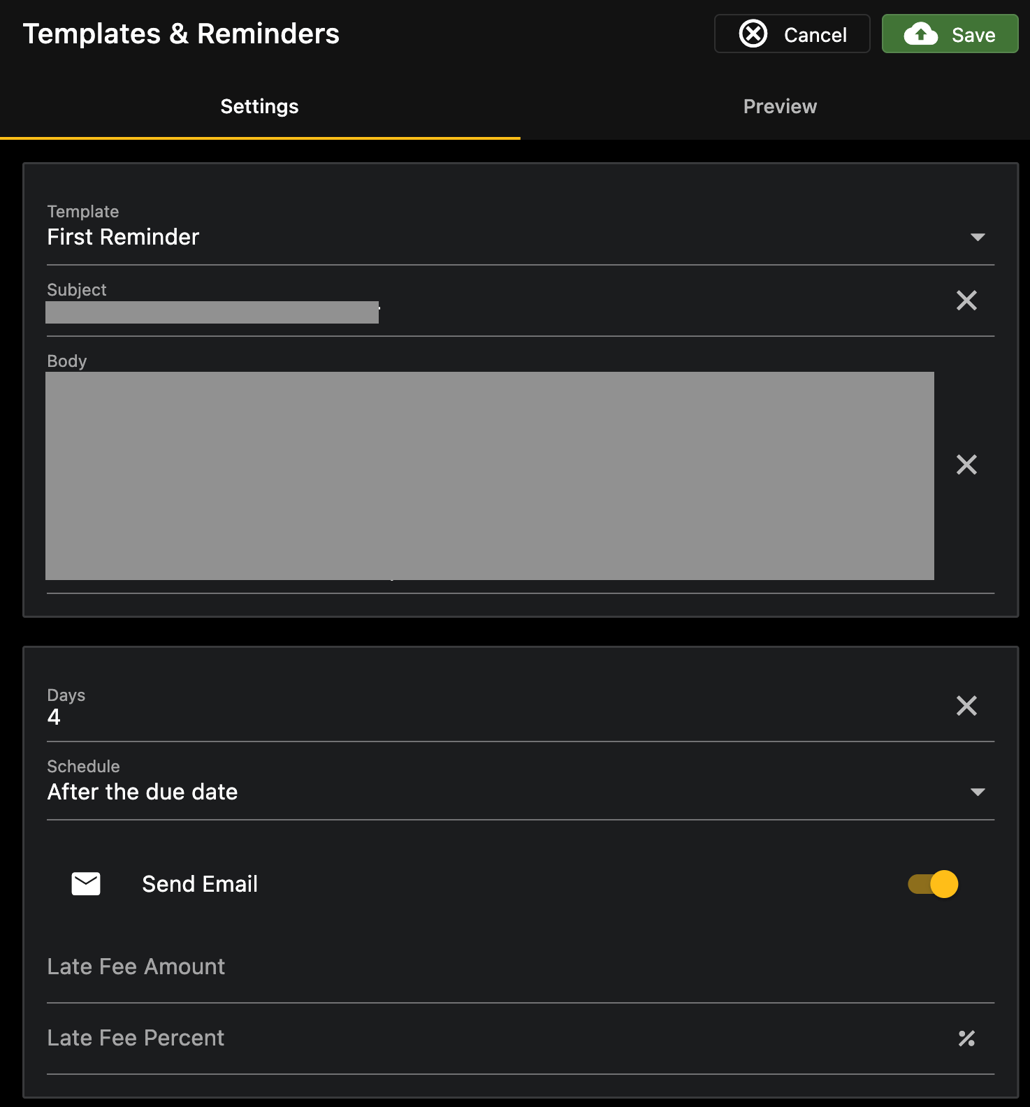

Hello team,
I’m using IN 5.6.6 and I assume one of the updates from last months broke the reminders.
Here are my reminder settings for the first reminder:
  • Days: 4
  • Schedule: After the due date
  • Send Email: yes
The “Due Date” and “Next Send Date” are shown correctly on every invoice, but although no reminder has been sent to the customer. In the “Activity”-Tab there is also no sign of the reminder.
I can send the reminder manually, but the “Next Send Date” stays the same.
Customer settings for reminders are empty (default).

  1. Is this a reminder template?
I don’t know what you mean by this. Attached you find my settings for the first reminder.
AND is this reminder enabled?
:heavy_check_mark: As shown in the screenshot above: It is enabled.
AND is send emails enabled?
:heavy_check_mark: The client setting Send Reminders was empty (default), but to avoid potential errors I set this option to Enabled.
