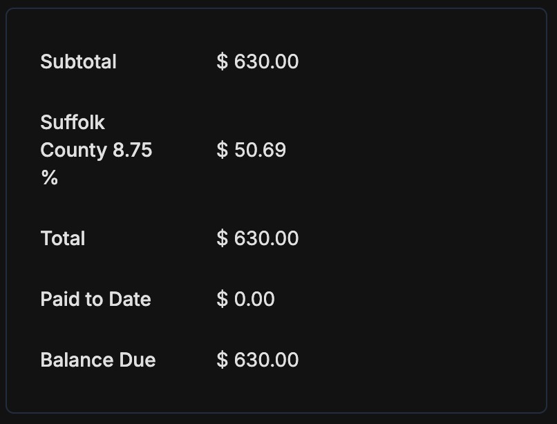

I have not had a problem in over a year or so, just today I see the tax is 1) not calculating correctly 2) not being added to the total balance. I’ve tried everything I can think of but no progress. Is anyone else experiencing this?
I think I solved this last night - I think any change to the tax settings applies only to new invoices. Any drafts or saved invoices need to be deleted and redone in order to see the change.
Please let me know if I’m right before I start redoing all the invoices that were created incorrectly.
