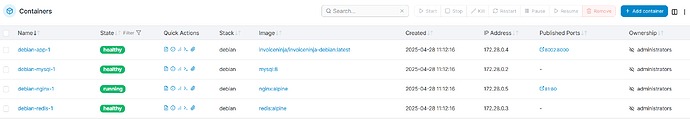

I cannot open Invoiceninja
Version V5.11.72
Environment Docker / Synology
I have installed Invoceninja.
All containers are running fine.
I have adjusted the following in the .env: APP_URL=http://192.168.178.103:8002
I open the port in the firewall (router and Synology).
When I call up the URL via the browser, the following error message appears: Connection failed
What strikes me is that the published port is not displayed in Portainer.io.
Can anyone help me further?

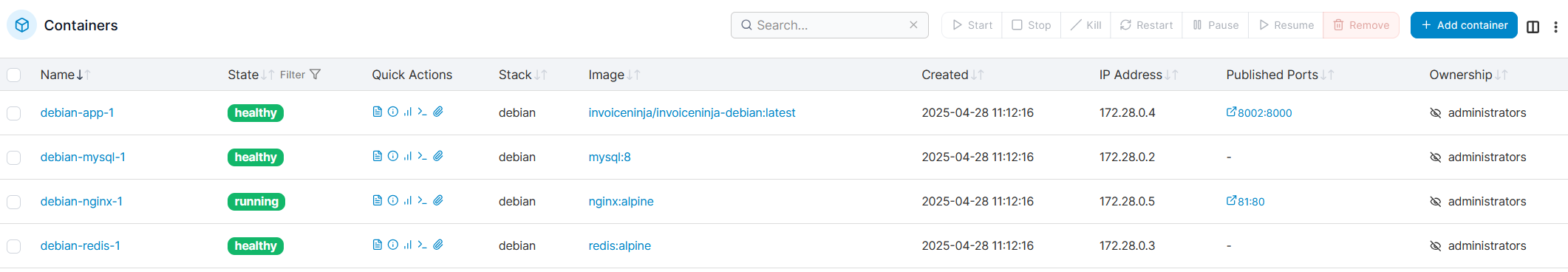

Thank you for your quick reply!
I have corrected the port and it is now displayed. Unfortunately, I still get the same error message.
What else can I try?

If your APP_URL ends up on Port 8002 then this port imo have to be set up in the nginx-container.
In my docker setup for invoiceninja, only the nginx-container has defined ports.
How should I set this up?
Show your docker-compose.yml please
