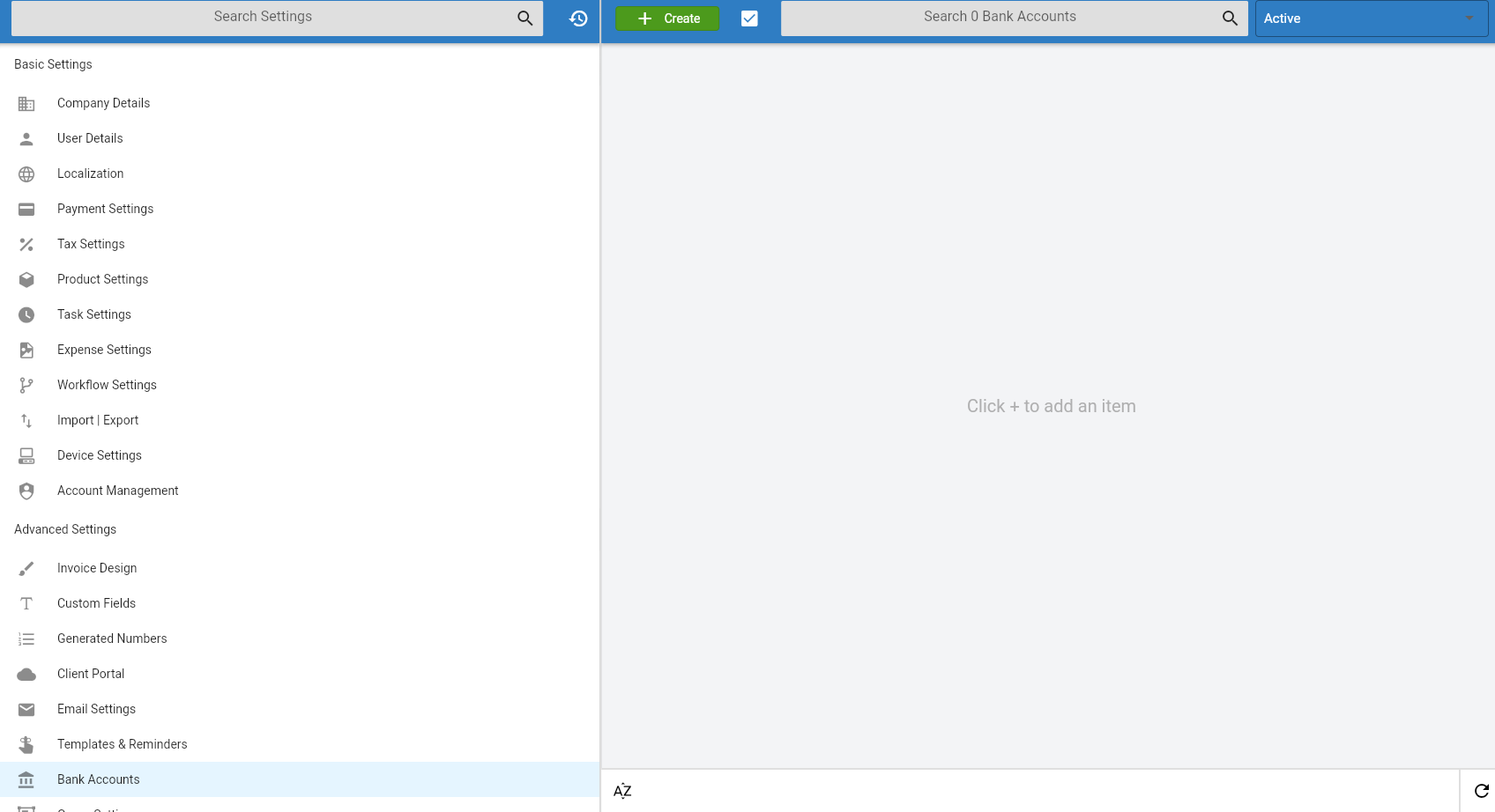

I don’t see Settings > Bank Account > Connect accounts?
However, I don’t understand how to get this working. When I go to settings > bank accounts and create a bank account, it just asks for a name and that’s it. There’s no way to perform steps to integrate it with my bank/Yodlee.
Is there some further documentation? How can I get this set up?
