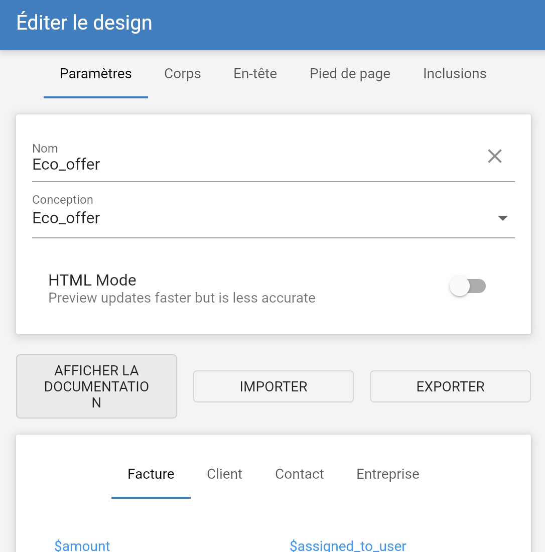

While I edit my offer desing, I am suprise to see that (the word Facture (Invoice) at the bottom)
Should I not see Offer (Offre) instead of Invocie (Facrure)?
I created my offer design based on my Invoice design. I guess the new design kept invoice settings?
We only support the swiss qr variable in invoices. Would it be usual to use this in a quote/offer?
Onnestly, I do not know. As I am asking a 40% before the start of the job, I got the idea to add an QR for the 40% amount. That’s the reason why I tried it. But in other sense, I can send a invoice for that amount. It’s not a bif issuer of it’s not support.
But, it higlighted. As I create a offer design, startit from an invoice template, I was wondering if the fact to read “Facture” instead of “Offer”, if that an issue. Behing the Invoice design, would have some coding from invoice design?
@pierrot10
We use the same designs, but we just switch the translations of the type of document, so we can use a single design for invoice / quote / credit / purchase orders etc.
