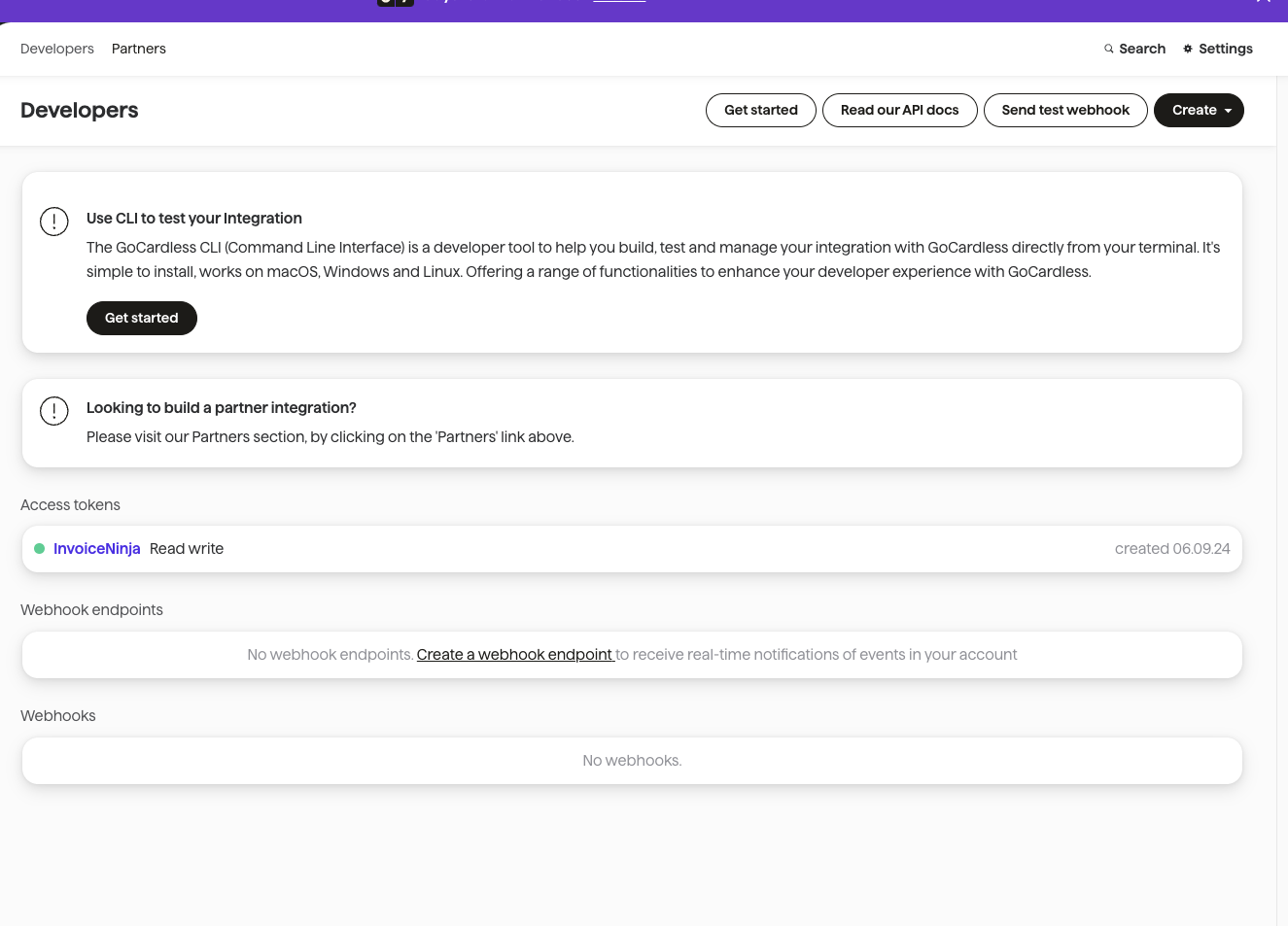

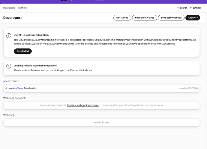

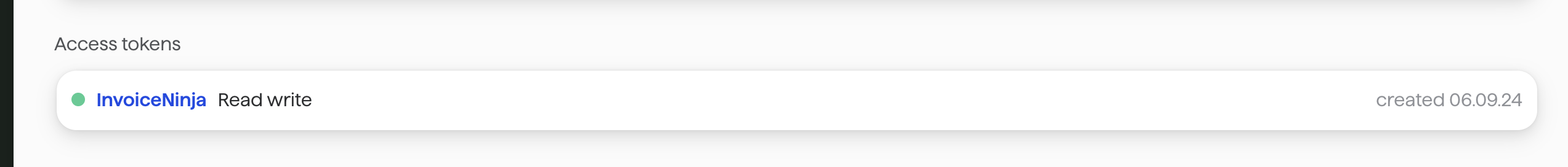

I am currently trying to setup GoCardless. I set up an access token, however it doesnt show me an ID. I just entered a “Name” and it gave me the secret.

I found this article but I’m not sure if we use the new or old GoCardless API
Probably the old then, then there is no way to get it working atm?

You should be able to find the credentials on the GoCardless/Nordigen bank account data API developer dashboard.
Can you guide me where I find it?
When I create one it just gives me an access token.
If you click ‘Create new’ on this page you’ll receive a secret and key
https://bankaccountdata.gocardless.com/user-secrets/
Thank you, I didnt know this seperate page for account data exists!
