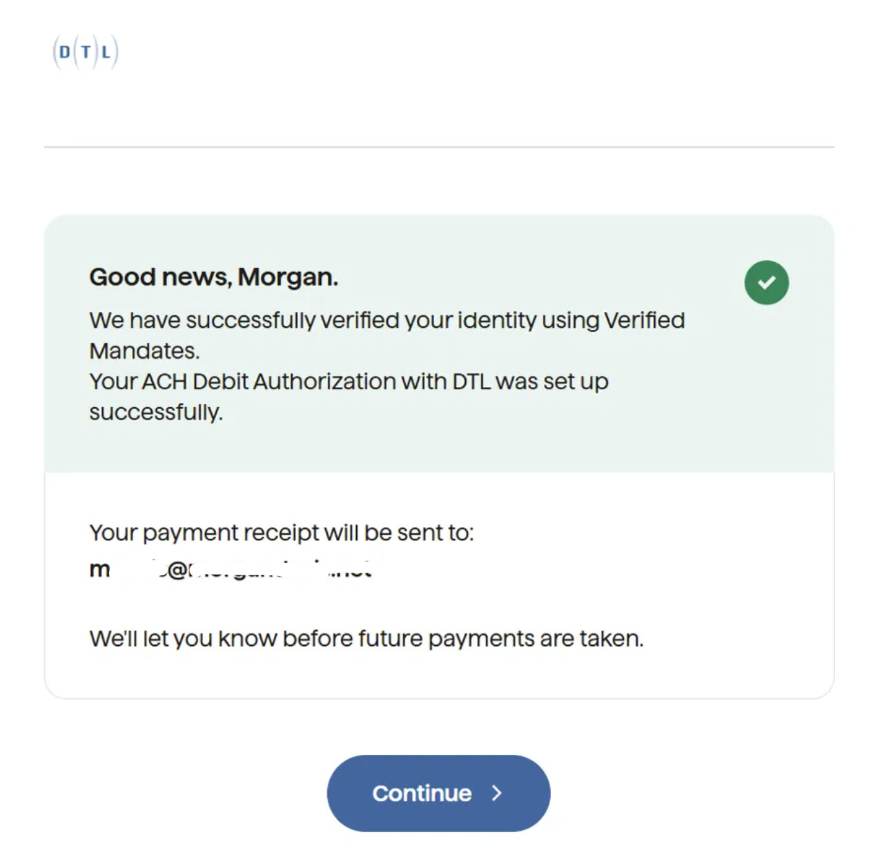

  4. The GoCardless hosted flow appears correctly: “Set up your ACH Debit Authorization”, country United States, USD, US address fields, my company logo.
  5. Complete the flow with real name, address, and US routing/account details.
  6. GoCardless confirms: identity verified via Verified Mandates, ACH Debit Authorization set up successfully, email confirmation received.

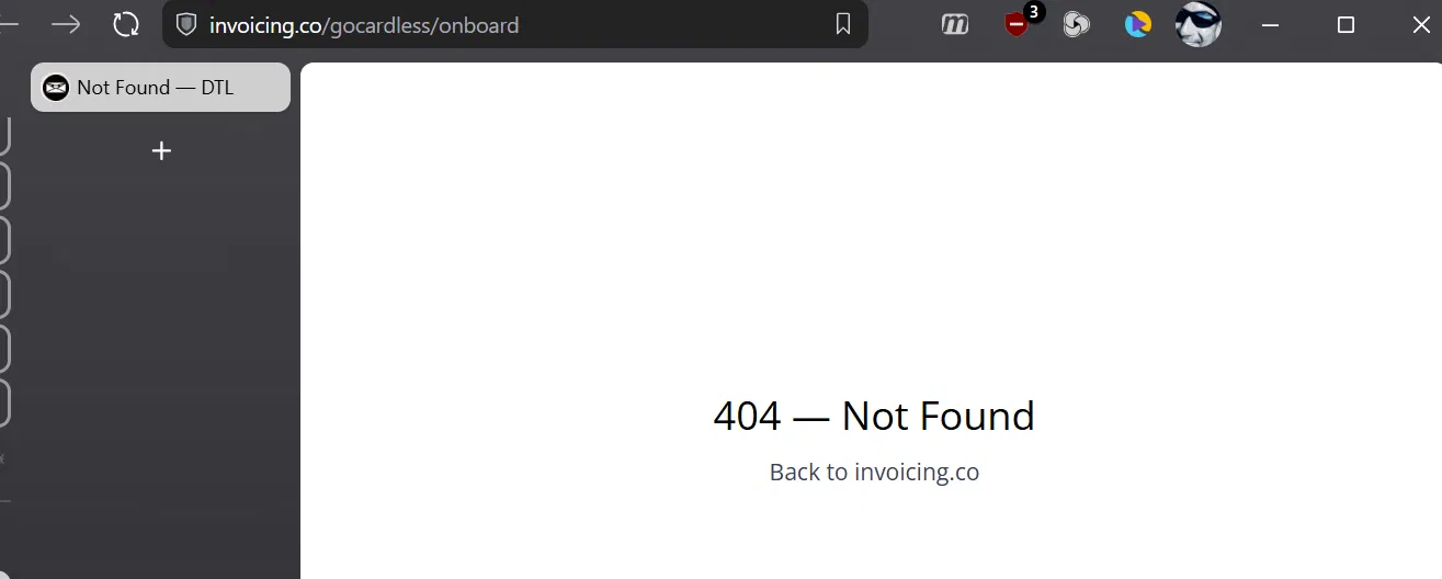

  1. GoCardless’s post-signup handoff sends you to https://invoicing.co/gocardless/onboard, which returns 404 Not Found.
