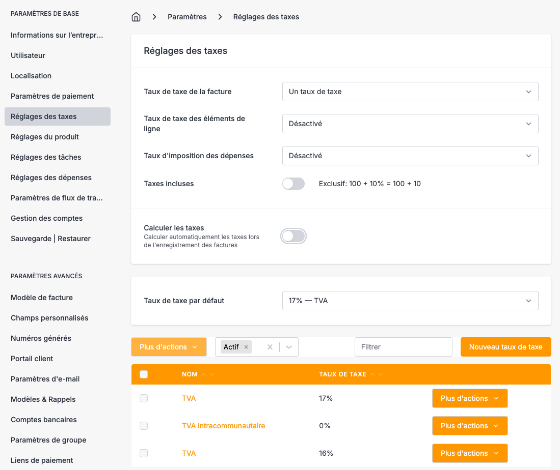

Then, is there a way for every invoice I create to have the default tva included in the invoice ? That’s another thing I don’t get : What is the point of having a Default VAT in the taxes setting ? It’s use should be to, by default (hence the label) used in invoices, no ? What am I missing ?
And, now that I think about it, wasn’t that the case in the V4 ?
Just to be sure, I’m talking about the “default VAT rate” → “Taux de taxe par défaut” in that screenshot.
(oh, and pardon my french :smiley: )

The front ends currently set the default tax rates.
The API never forces a default as this would break the UI/API relationship.
ie. default is set in the settings.
User creates an invoice in the UI and the taxes are set there.
User removes the taxes from the UI and then saves.
The api would then override and inject the taxes again which would be incorrect1.

Agreed, I’m not suggesting we make it a required field.
With the following request the API can apply the defaults without affecting the frontends.
curl -X POST 'https://invoicing.co/api/v1/invoices' \
-H "Content-Type:application/json" \
-d '{"client_id":"4QbYZ43Kdz"}' \
-H "X-API-TOKEN: ..." \
-H "X-API-SECRET:password" \
-H "X-Requested-With: XMLHttpRequest"
Note: the defaults should only be applied when creating the invoice, not when updating it.

Understood, there is no logic enabling this currently.
