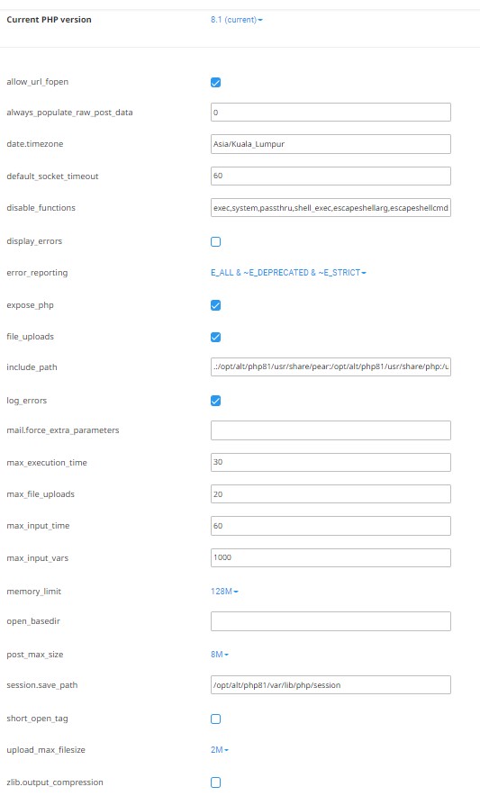

I did switch to PHP8.1 but somehow it appears that PHP selector reports contradicting result.

From the screenshots it seems most likely the issue is related to the PHP version
I was hoping to gather some info before I contact my webhosting. I’d appreciate it if you could have a look at the following screenshots to see if there is anything obvious. I used PHP selector to switch to the PHP ver8.1 as well but I still get the same error.

The screenshots look ok to me
