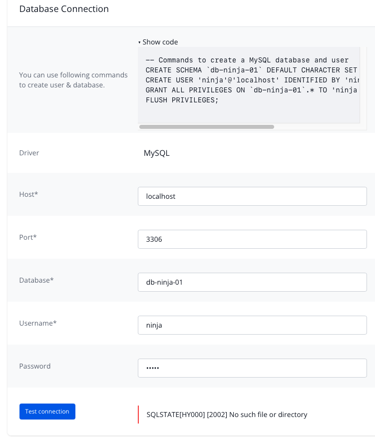

I need to create the MySQL database. So I am not sure what to enter here nor do I know where to enter the code shown:

Do I run that in the shell of the NAS? I just tried that and got errors. This looks like SQL code to me but not sure where I run that…
Here’s a screenshot of what I am seeing…
So I went back to the default localhost and tried again. This time it looks like I get a connection but no database…
So where do I run the SQL code…

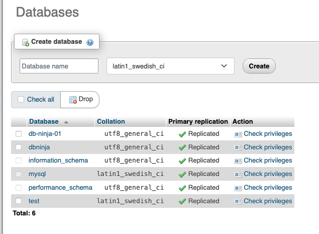

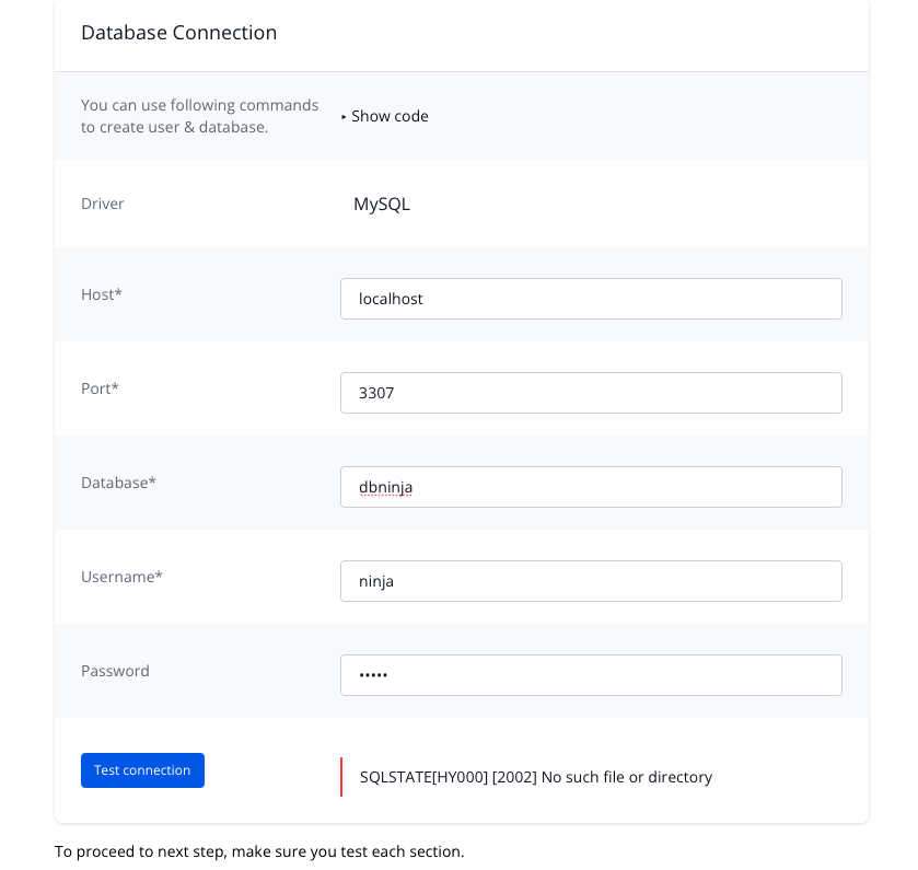

So thank you - I am closer and was able to create the database in phpMyAdmin, but I am still getting an error in InvoiceNinja that there is no such file…
But the database is there in MariaDB. Now I can’t set MariaDB as the driver - so I don’t know if that’s an issue but MariaDB and MySQL are compatible…
As suggested above, I am running MariaDB 10. And I’m using port 3307.
I tried creating db-ninja-01 as was originally there - didn’t work. I tried creating another database, dbninja. Still doesn’t work.
Getting this to run should not be this hard!
Since I can only put in one image per post, here’s a picture from phpMyAdmin

As shown in the picture above:
It says there’s no such file but there is…

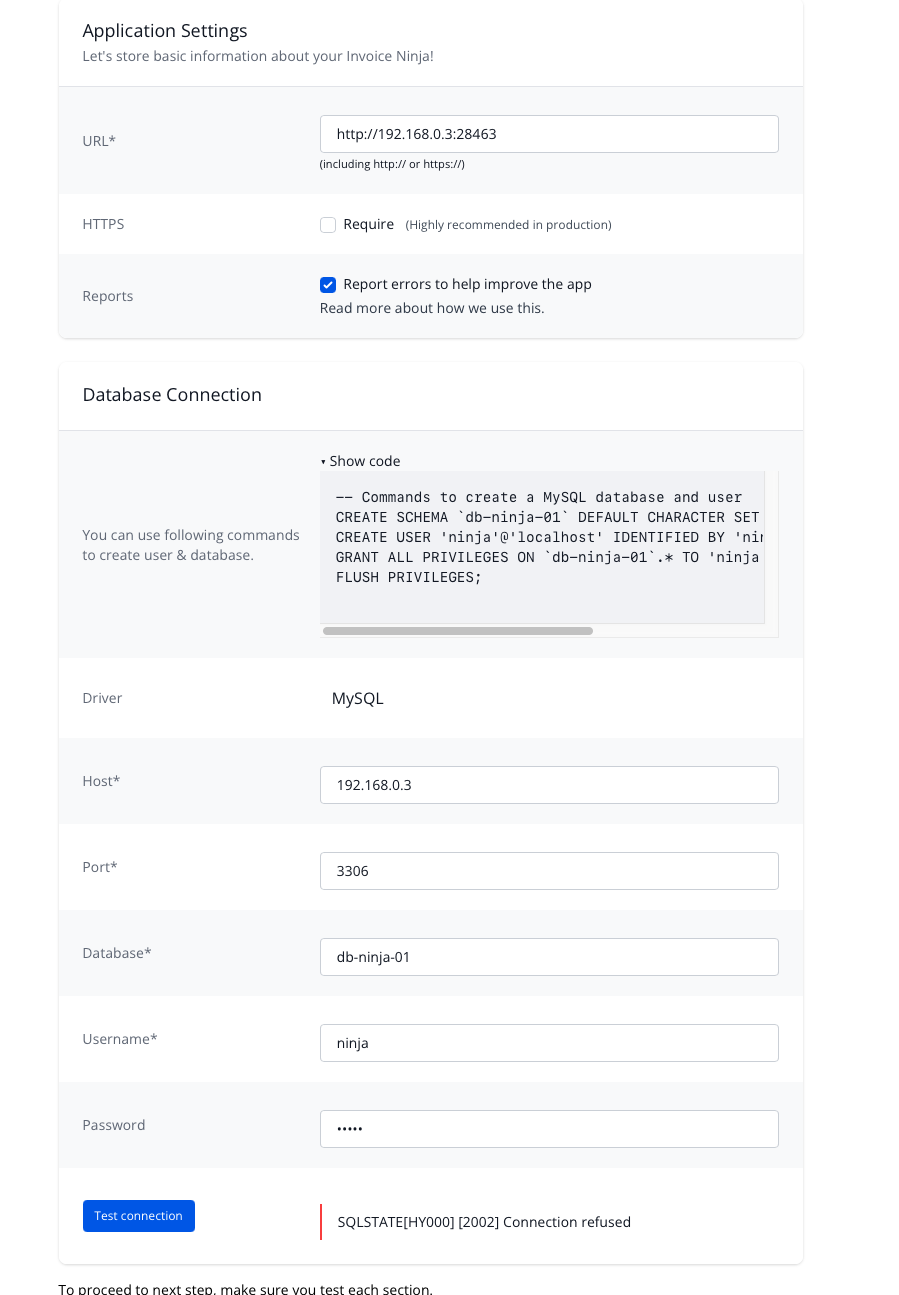

OK - SUCCESS! I received some instructions from QNAP that allowed me to connect to the database not via localhost but via the IP address of the NAS. I set up the MariaDB server to allow external connections for the ninja user. Now it works and I can connect to the database.
Yeah, I’m not connecting via localhost so hope that is not too much of a problem.
