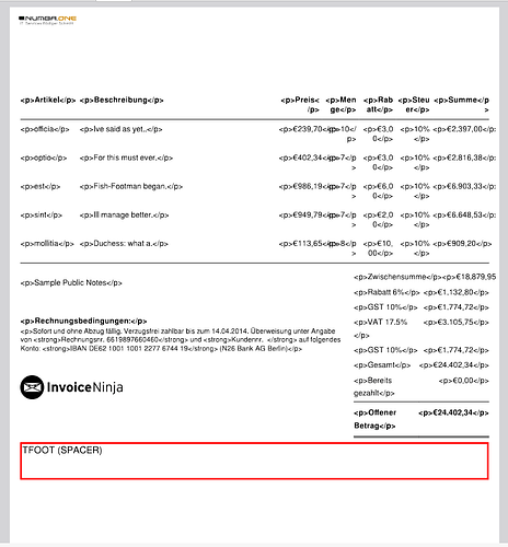

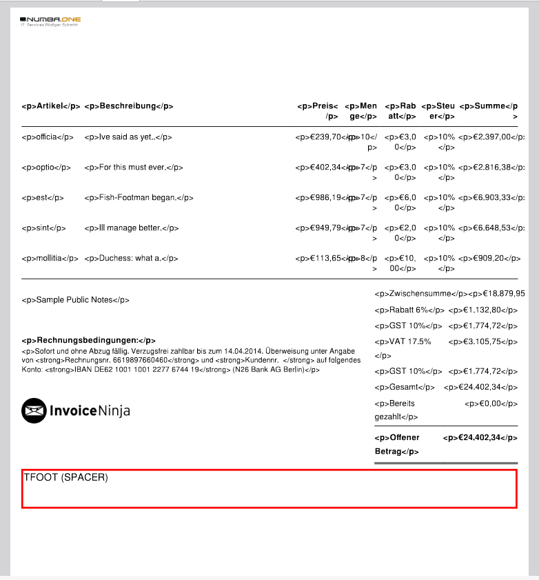

Hello, people,
I’m frustrated, because I don’t know if it’s me who’s “faulty” or if it’s a bug.
It’s now the third time that when I try to create a new invoice-template, that I get a design-problem like this (not the red bordered footer, the product tables with the paragraph-codes):
Why is that so? Am I just dumb? I’m not a developer but an “IT-specialist”.
Hope someone can help. However, thank you!
PS: Oh, I forgot to mention, that the table-header won’t be shown if the option to hide empty columns is activated (what I also want to).
@david do you have any ideas?
Hello @all,
I snipped out the html-code of one of my templates with an example-preview Invoice Ninja created for testing. Maybe this can help to find the cause of the problem. I X-ed out (hopefully) all sensitive data, but have to mention, that – as I am German – I used Umlaute and other special characters. I mention this, because it seems that paragraph-code is somehow translated into character-code – I don’t know the correct English technical term – like   for non-breakable space-characters.
Hoewever, here’s the code.

        <table id="entity-details" cellspacing="0" cellpadding="0">
            <th>Kundennummer</th> <th> </th>
        <tr><th data-state="encoded-html" data-ref="entity_details-invoice.number_label">&lt;p&gt;Rechnungsnummer&lt;/p&gt;
</th><th data-state="encoded-html" data-ref="entity_details-invoice.number">&lt;p&gt;5025964551264&lt;/p&gt;
</th></tr><tr><th data-state="encoded-html" data-ref="entity_details-invoice.date_label">&lt;p&gt;Rechnungsdatum&lt;/p&gt;
</th><th data-state="encoded-html" data-ref="entity_details-invoice.date">&lt;p&gt;18.11.1994&lt;/p&gt;
</th></tr><tr><th data-state="encoded-html" data-ref="entity_details-invoice.custom1_label">&lt;p&gt;Leistungsdatum&lt;/p&gt;
</th><th data-state="encoded-html" data-ref="entity_details-invoice.custom1">&lt;p&gt;20.06.2004&lt;/p&gt;
</th></tr><tr><th data-state="encoded-html" data-ref="entity_details-invoice.po_number_label">&lt;p&gt;Bestellnummer&lt;/p&gt;
</th><th data-state="encoded-html" data-ref="entity_details-invoice.po_number">&lt;p&gt;Corrupti.&lt;/p&gt;
</th></tr><tr hidden="1"><th data-state="encoded-html" data-ref="entity_details-invoice.project_label">&lt;p&gt;5025964551264.project_label&lt;/p&gt;
</th><th data-state="encoded-html" data-ref="entity_details-invoice.project">&lt;p&gt;5025964551264.project&lt;/p&gt;
</th></tr></table>

                    <table id="product-table" cellspacing="0" data-ref="table"><thead><th data-state="encoded-html" data-ref="product_table-product.item-th" hidden="1">&lt;p&gt;Artikel&lt;/p&gt;
</th><th data-state="encoded-html" data-ref="product_table-product.description-th" hidden="1">&lt;p&gt;Beschreibung&lt;/p&gt;
</th><th data-state="encoded-html" data-ref="product_table-product.unit_cost-th" hidden="1">&lt;p&gt;Preis&lt;/p&gt;
</th><th data-state="encoded-html" data-ref="product_table-product.quantity-th" hidden="1">&lt;p&gt;Menge&lt;/p&gt;
</th><th data-state="encoded-html" data-ref="product_table-product.discount-th" hidden="1">&lt;p&gt;Rabatt&lt;/p&gt;
</th><th data-state="encoded-html" data-ref="product_table-product.tax1-th" hidden="1">&lt;p&gt;Steuer&lt;/p&gt;
</th><th data-state="encoded-html" data-ref="product_table-product.line_total-th" hidden="1">&lt;p&gt;Summe&lt;/p&gt;
</th></thead><tbody><tr><td data-state="encoded-html" data-ref="product_table-product.item-td">&lt;p&gt;ducimus&lt;/p&gt;
</td><td data-state="encoded-html" data-ref="product_table-product.description-td">&lt;p&gt;Alice, Have you.&lt;/p&gt;
</td><td data-state="encoded-html" style="white-space: nowrap;" data-ref="product_table-product.unit_cost-td">&lt;p&gt;&euro;947,45&lt;/p&gt;
</td><td data-state="encoded-html" data-ref="product_table-product.quantity-td">&lt;p&gt;4&lt;/p&gt;
</td><td data-state="encoded-html" data-ref="product_table-product.discount-td">&lt;p&gt;&euro;7,00&lt;/p&gt;
</td><td data-state="encoded-html" data-ref="product_table-product.tax1-td">&lt;p&gt;10%&lt;/p&gt;
</td><td data-state="encoded-html" data-ref="product_table-product.line_total-td">&lt;p&gt;&euro;3.789,80&lt;/p&gt;
</td></tr><tr><td data-state="encoded-html" data-ref="product_table-product.item-td">&lt;p&gt;aspernatur&lt;/p&gt;
</td><td data-state="encoded-html" data-ref="product_table-product.description-td">&lt;p&gt;Knave. The Knave.&lt;/p&gt;
</td><td data-state="encoded-html" style="white-space: nowrap;" data-ref="product_table-product.unit_cost-td">&lt;p&gt;&euro;411,63&lt;/p&gt;
</td><td data-state="encoded-html" data-ref="product_table-product.quantity-td">&lt;p&gt;3&lt;/p&gt;
</td><td data-state="encoded-html" data-ref="product_table-product.discount-td">&lt;p&gt;&euro;2,00&lt;/p&gt;
</td><td data-state="encoded-html" data-ref="product_table-product.line_total-td">&lt;p&gt;&euro;1.234,89&lt;/p&gt;
</td></tr><tr><td data-state="encoded-html" data-ref="product_table-product.item-td">&lt;p&gt;dolorem&lt;/p&gt;
</td><td data-state="encoded-html" data-ref="product_table-product.description-td">&lt;p&gt;Dinah my dear! I.&lt;/p&gt;
</td><td data-state="encoded-html" style="white-space: nowrap;" data-ref="product_table-product.unit_cost-td">&lt;p&gt;&euro;427,50&lt;/p&gt;
</td><td data-state="encoded-html" data-ref="product_table-product.discount-td">&lt;p&gt;&euro;10,00&lt;/p&gt;
</td><td data-state="encoded-html" data-ref="product_table-product.line_total-td">&lt;p&gt;&euro;1.282,50&lt;/p&gt;
</td></tr><tr><td data-state="encoded-html" data-ref="product_table-product.item-td">&lt;p&gt;vitae&lt;/p&gt;
</td><td data-state="encoded-html" data-ref="product_table-product.description-td">&lt;p&gt;I was thinking I.&lt;/p&gt;
</td><td data-state="encoded-html" style="white-space: nowrap;" data-ref="product_table-product.unit_cost-td">&lt;p&gt;&euro;170,65&lt;/p&gt;
</td><td data-state="encoded-html" data-ref="product_table-product.quantity-td">&lt;p&gt;7&lt;/p&gt;
</td><td data-state="encoded-html" data-ref="product_table-product.discount-td">&lt;p&gt;&euro;6,00&lt;/p&gt;
</td><td data-state="encoded-html" data-ref="product_table-product.line_total-td">&lt;p&gt;&euro;1.194,55&lt;/p&gt;
</td></tr><tr><td data-state="encoded-html" data-ref="product_table-product.item-td">&lt;p&gt;voluptate&lt;/p&gt;
</td><td data-state="encoded-html" data-ref="product_table-product.description-td">&lt;p&gt;An obstacle that.&lt;/p&gt;
</td><td data-state="encoded-html" style="white-space: nowrap;" data-ref="product_table-product.unit_cost-td">&lt;p&gt;&euro;279,71&lt;/p&gt;
</td><td data-state="encoded-html" data-ref="product_table-product.quantity-td">&lt;p&gt;6&lt;/p&gt;
</td><td data-state="encoded-html" data-ref="product_table-product.line_total-td">&lt;p&gt;&euro;1.678,26&lt;/p&gt;
</td></tr></tbody></table>
                    <table id="task-table" cellspacing="0" data-ref="table"></table>
                    <table id="delivery-note-table" cellspacing="0" data-ref="table"></table>
                    <table id="statement-invoice-table" cellspacing="0" data-ref="table"></table>
                    <div id="statement-invoice-table-totals" data-ref="statement-totals"></div>
                    <table id="statement-payment-table" cellspacing="0" data-ref="table"></table>
                    <div id="statement-payment-table-totals" data-ref="statement-totals"></div>
                    <table id="statement-credit-table" cellspacing="0" data-ref="table"></table>
                    <div id="statement-credit-table-totals" data-ref="statement-totals"></div>
                    <table id="statement-aging-table" cellspacing="0" data-ref="table"></table>
                    <div id="statement-aging-table-totals" data-ref="statement-totals"></div>
                    <!-- Folgende Zeile beinhaltet ALLES hinsichtlich dem,
                    was unterhalb der Positionstabelle kommt //-->
                    <div id="table-totals" cellspacing="0" dir="ltr"><div class="stamp is-paid"> Bezahlt</div><div style="display: flex; flex-direction: column;"><p data-state="encoded-html" data-ref="total_table-public_notes" style="text-align: left;">&lt;p&gt;Sample Public Notes&lt;/p&gt;
</p><p style="text-align: left; display: flex; flex-direction: column; page-break-inside: auto;"><span data-state="encoded-html" data-ref="total_table-terms-label" style="font-weight: bold; text-align: left; margin-top: 1rem;">&lt;p&gt;Rechnungsbedingungen:&lt;/p&gt;
</span><span data-state="encoded-html" data-ref="total_table-terms" style="text-align: left;">&lt;p&gt;Sofort und ohne Abzug f&auml;llig. Verzugsfrei zahlbar bis zum 30.01.2003. &Uuml;berweisung unter Angabe von &lt;strong&gt;Rechnungsnr.&nbsp;5025964551264&lt;/strong&gt; und &lt;strong&gt;Kundennr.&nbsp; &lt;/strong&gt; auf folgendes Konto: &lt;strong&gt;IBAN&nbsp;DEXX&nbsp;XXXX&nbsp;XXXX&nbsp;XXXX&nbsp;XXXX&nbsp;XX&lt;/strong&gt; (XXX&nbsp;XXX&nbsp;XXX&nbsp;XXXX)&lt;/p&gt;
</span></p><img style="max-width: 50%; height: auto;" src="" id="contact-signature"><div style="display: flex; align-items: flex-start; page-break-inside: auto;"><img src="https://invoicing.co/images/new_logo.png" style="height: 2.5rem; margin-top: 1.5rem;" id="invoiceninja-whitelabel-logo"></div></div><div class="totals-table-right-side" dir="ltr"><div><span data-state="encoded-html" data-ref="totals_table-subtotal-label">&lt;p&gt;Zwischensumme&lt;/p&gt;
</span><span data-state="encoded-html" data-ref="totals_table-subtotal">&lt;p&gt;&euro;8.572,61&lt;/p&gt;
</span></div><div><span data-state="encoded-html" data-ref="totals_table-discount-label">&lt;p&gt;Rabatt 2%&lt;/p&gt;
</span><span data-state="encoded-html" data-ref="totals_table-discount">&lt;p&gt;&euro;171,45&lt;/p&gt;
</span></div><div><span data-state="encoded-html" hidden="1" data-ref="totals_table-custom_surcharge1-label">&lt;p&gt;&lt;/p&gt;
</span><span data-state="encoded-html" hidden="1" data-ref="totals_table-custom_surcharge1">&lt;p&gt;&euro;0,00&lt;/p&gt;
</span></div><div><span data-state="encoded-html" hidden="1" data-ref="totals_table-custom_surcharge2-label">&lt;p&gt;&lt;/p&gt;
</span><span data-state="encoded-html" hidden="1" data-ref="totals_table-custom_surcharge2">&lt;p&gt;&euro;0,00&lt;/p&gt;
</span></div><div><span data-state="encoded-html" hidden="1" data-ref="totals_table-custom_surcharge3-label">&lt;p&gt;&lt;/p&gt;
</span><span data-state="encoded-html" hidden="1" data-ref="totals_table-custom_surcharge3">&lt;p&gt;&euro;0,00&lt;/p&gt;
</span></div><div><span data-state="encoded-html" hidden="1" data-ref="totals_table-custom_surcharge4-label">&lt;p&gt;&lt;/p&gt;
</span><span data-state="encoded-html" hidden="1" data-ref="totals_table-custom_surcharge4">&lt;p&gt;&euro;0,00&lt;/p&gt;
</span></div><div><span data-state="encoded-html" data-ref="totals-table-total_tax_0-label">&lt;p&gt;GST 10%&lt;/p&gt;
</span><span data-state="encoded-html" data-ref="totals-table-total_tax_0">&lt;p&gt;&euro;840,12&lt;/p&gt;
</span></div><div><span data-state="encoded-html" data-ref="totals-table-total_tax_1-label">&lt;p&gt;VAT 17.5%&lt;/p&gt;
</span><span data-state="encoded-html" data-ref="totals-table-total_tax_1">&lt;p&gt;&euro;1.470,20&lt;/p&gt;
</span></div><div><span data-state="encoded-html" data-ref="totals-table-line_tax_0-label">&lt;p&gt;GST 10%&lt;/p&gt;
</span><span data-state="encoded-html" data-ref="totals-table-line_tax_0">&lt;p&gt;&euro;840,12&lt;/p&gt;
</span></div><div><span data-state="encoded-html" data-ref="totals_table-total-label">&lt;p&gt;Gesamt&lt;/p&gt;
</span><span data-state="encoded-html" data-ref="totals_table-total">&lt;p&gt;&euro;11.551,60&lt;/p&gt;
</span></div><div><span data-state="encoded-html" data-ref="totals_table-paid_to_date-label">&lt;p&gt;Bereits gezahlt&lt;/p&gt;
</span><span data-state="encoded-html" data-ref="totals_table-paid_to_date">&lt;p&gt;&euro;0,00&lt;/p&gt;
</span></div><div><span data-state="encoded-html" data-ref="totals_table-outstanding-label">&lt;p&gt;Offener Betrag&lt;/p&gt;
</span><span data-state="encoded-html" data-ref="totals_table-outstanding">&lt;p&gt;&euro;11.551,60&lt;/p&gt;
</span></div><div><span></span><span></span></div></div></div>
