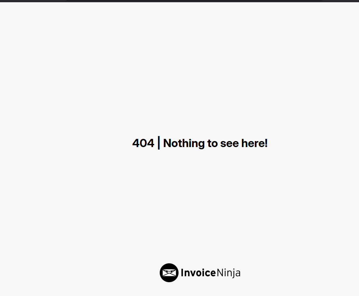

I run this SQL-Query and got now an error 404-Nothing to see here
Damn
How can I reset the executed SQL query?

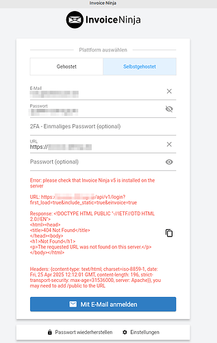

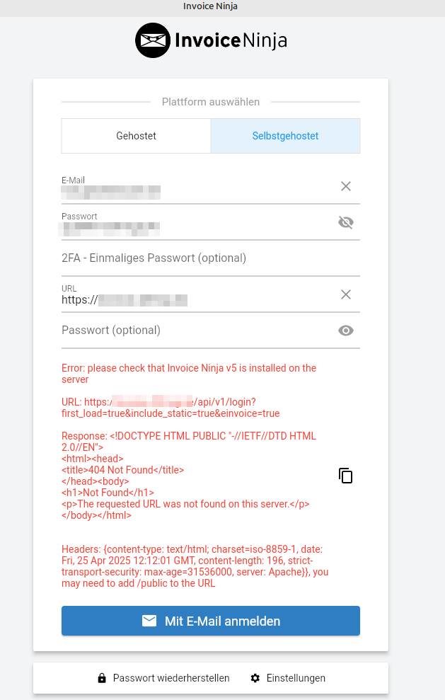

Thank you! That worked to solve the issue with 404
Does anyone have any idea how I can solve the problem of not being able to log in?

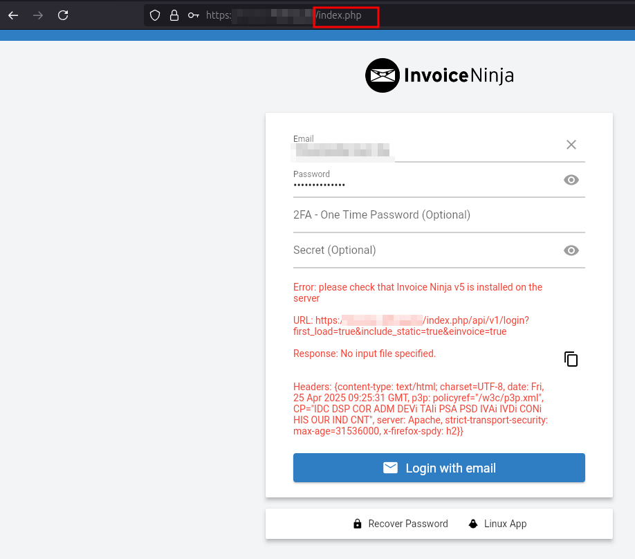

I still get the following error message:
Error: please check that Invoice Ninja v5 is installed on the server
URL: https://xxxmywebsite.com/index.php/api/v1/login?first_load=true&include_static=true&einvoice=true
Response: No input file specified.
Headers: {content-type: text/html; charset=UTF-8, date: Fri, 25 Apr 2025 09:25:31 GMT, p3p: policyref=“/w3c/p3p.xml”, CP=“IDC DSP COR ADM DEVi TAIi PSA PSD IVAi IVDi CONi HIS OUR IND CNT”, server: Apache, strict-transport-security: max-age=31536000, x-firefox-spdy: h2}}
Do you see the same error in the desktop app?
Unfortunally, yes…
You shouldn’t see index.php in the URL, I suggest checking that mod_rewrite is enabled
The index.php is called, for example, when I want to log in with the browser.
How can I check that mod_rewrite is enabled?

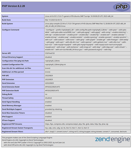

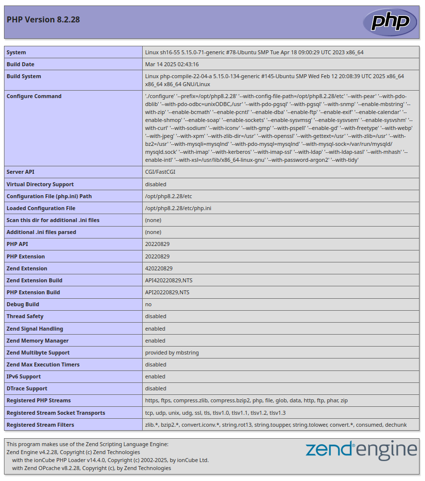

You can temporarily setup a phpinfo page to check the server’s settings
How can I do this?
Can you help me with this? How can I implement this?
Thank you. I’ll try it :face_blowing_a_kiss:
Ok, that worked. But I can’t find mod_rewrite in the overview.
Or should I look for other points?
Here is an example, the first entries…
