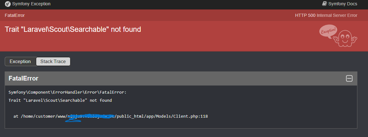

I run on v5.10.26
update to .27 .28 .29 runs correct.
As soon as i upgrade to 5.10.30 i get an error 500.
see nothing in server error log.
Greetz, Koen

Are there any details about the 500 error in the web server error logs?
If you can make the site private you can try setting APP_DEBUG to true in the .env file.
Did you check the lavarel log?
I’m on holiday right now… i’ll check in 2 weeks…
Are you using the release tar?
If not you may need to run composer install
No, the zip file and overwriting all the files.
Like i always did…
You need to use the tar file

We changed from zip to tar about 6 months ago.

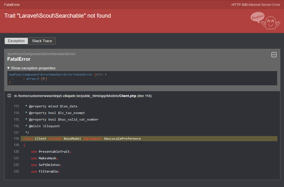

I get another error…
Can i send you the link private?
Sure, you can email it to [email protected]
Just to be clear… you can send us the error, please don’t send us the link to your site or any credentials.
