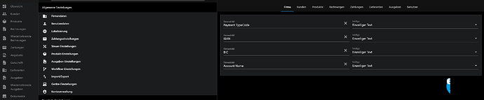

I tried to set up custom fields but I guess I am doing somehing wrong here:
Actually got it working now with:
For EN16963 it shows correctly in XML! :slight_smile:

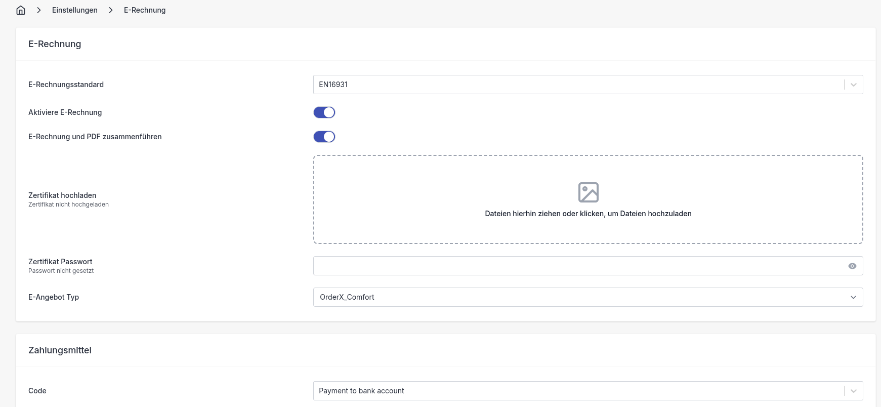

We have wired up the UI so that you can add the payment means into the system now.
The final piece is wiring up the backend to support placing these values onto the document itself.
I’ll be looking into that this week, so expect this to be available in the next release.

@Styless
Are you using the new Payment Means section in E-Invoice? This has been active for some time now.
@david
Yeah, already configured that. But the E-Invoice still shows only “Online Payment”

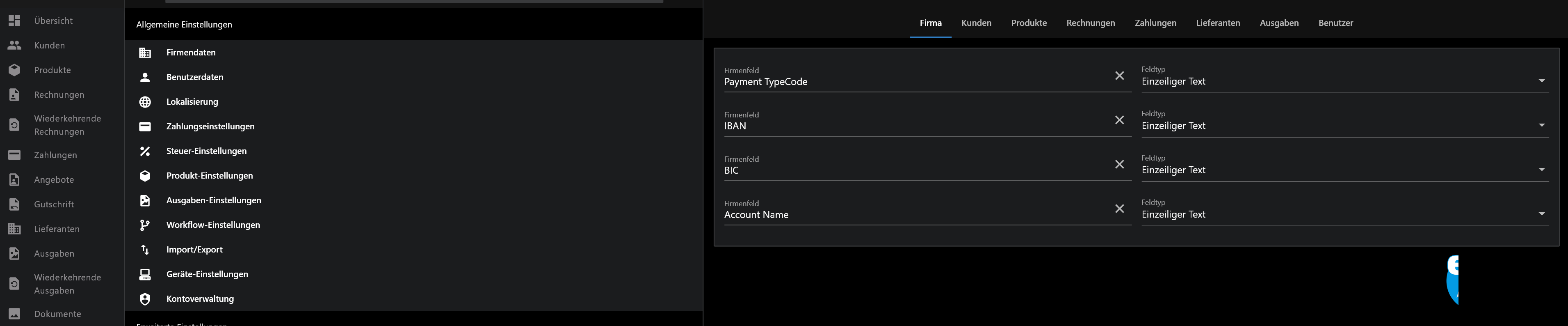

Hello,
Unfortunately, you don’t always get targeted help here, and the problem mentioned is one that affects virtually all Eruopeans.
I hope the team will provide more input options in the settings.
If you read the thread here carefully, there are reports of a working worgaround, but it is not really well documented. I also tried for some time, but then managed to get it working.
You have to go to “Custom fields” under settings and create 4 fields under “Company”
  1. Payment TypeCode
  2. IBAN
  3. BIC
  4. Account Name
(see screenshot)
Then go to Settings / Company data and you will see the 4 new fields.
Enter the number 30 as “Payment TypeCode”.
3) to 4) are your bank details. Where 4) is the name of your bank.
Please report back if it works for you.
Best regards,
Kai
