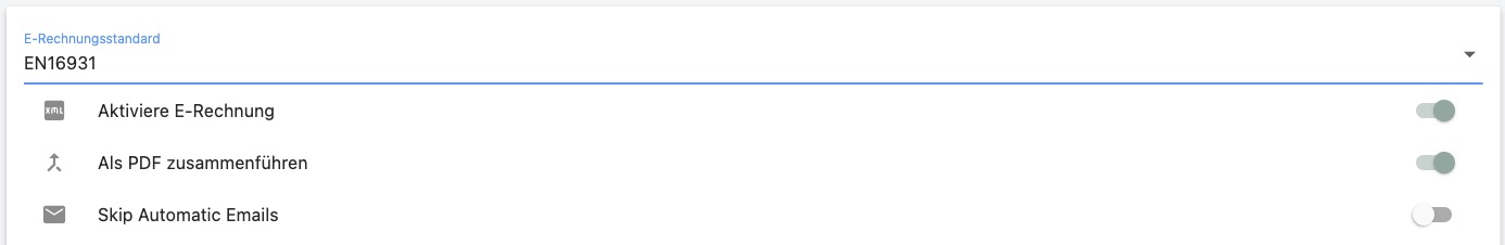

Seems that the E-Invoice is not compatible to EN 16931 / Zugferd 2.0.1

I have set the standard to EN 16931, but seems not OK?
