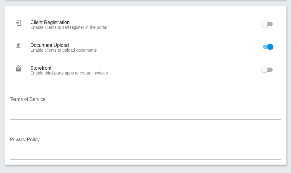

To enable a setting: Settings > Client portal > Documents Upload
This is what I refer to when I say “Client checkbox”:
Thanks!
Huh… I’m on v5.0.46-C37 - Docker
Presumably thought this was the newest… unless it’s some super new feature. Going into Settings > Client portal I see this (missing that setting):
Hey there, I think this feature in AP just handled recently. The update should arrive soon :+1:
Yep, I see the setting in v5.0.47-C38 - turned it on. I don’t think this works quite the way you guys hope it works… Everything ends up in “Client”, “Resources” is always checked off by default, nothing even gets to resources, nor is there any clear differentiation. Really is messy right now. Hopefully one day that feature gets there because - in theory - it seems useful.
Thank you for the feedback, we’re still actively working on it :+1:
