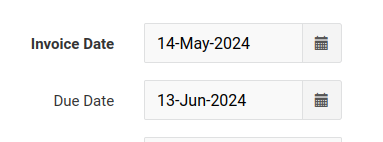

On my self hosted invoice ninja v4 when I select edit invoice the date is in the same format as the localisation format which I have set but in version 5 it doesn’t change on the date drop down.
Below is the version 4.
v4

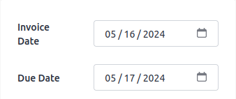

This is the format in v5:
v5
Is there a way to make the date system wide where ever they are used?

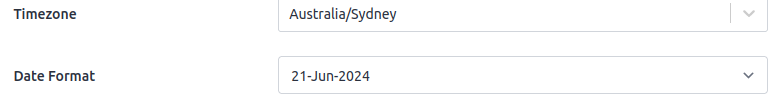

I have the v5 localisation set to:
It seems to change everywhere else except on the invoice edit screen.

The react application uses the browser defaults for inputs, the date format is always applied to the PDFs Client Portal however.

If you are on another site with the same date selectors, do you see the same (or different) styles for the date input?
We use whatever is the default based on what the browser tells us.
OK. I tried it on an Android tablet and the date is how I wanted it.
I tried it again on the Linux laptop and using Firefox and the date was still in USA format.
