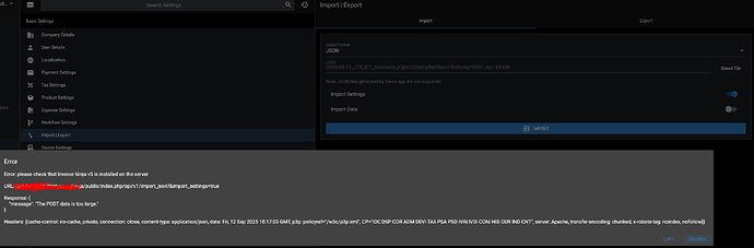

I have created a new company, and I want to copy all of my settings and custom invoice templates from the current to the new. I don’t need the data, just the settings and templates.
I would like the customers and vendors that I can do via CSV, but when I export from company A and import into company B, I get the below error
Response: {
“message”: “The POST data is too large.”
Headers: {cache-control: no-cache, private, connection: close, content-type: application/json, date: Fri, 12 Sep 2025 01:21:46 GMT, p3p: policyref=“/w3c/p3p.xml”, CP=“IDC DSP COR ADM DEVi TAIi PSA PSD IVAi IVDi CONi HIS OUR IND CNT”, server: Apache, transfer-encoding: chunked, x-robots-tag: noindex, nofollow}}
When exporting, I don’t see an option to ignore the data.

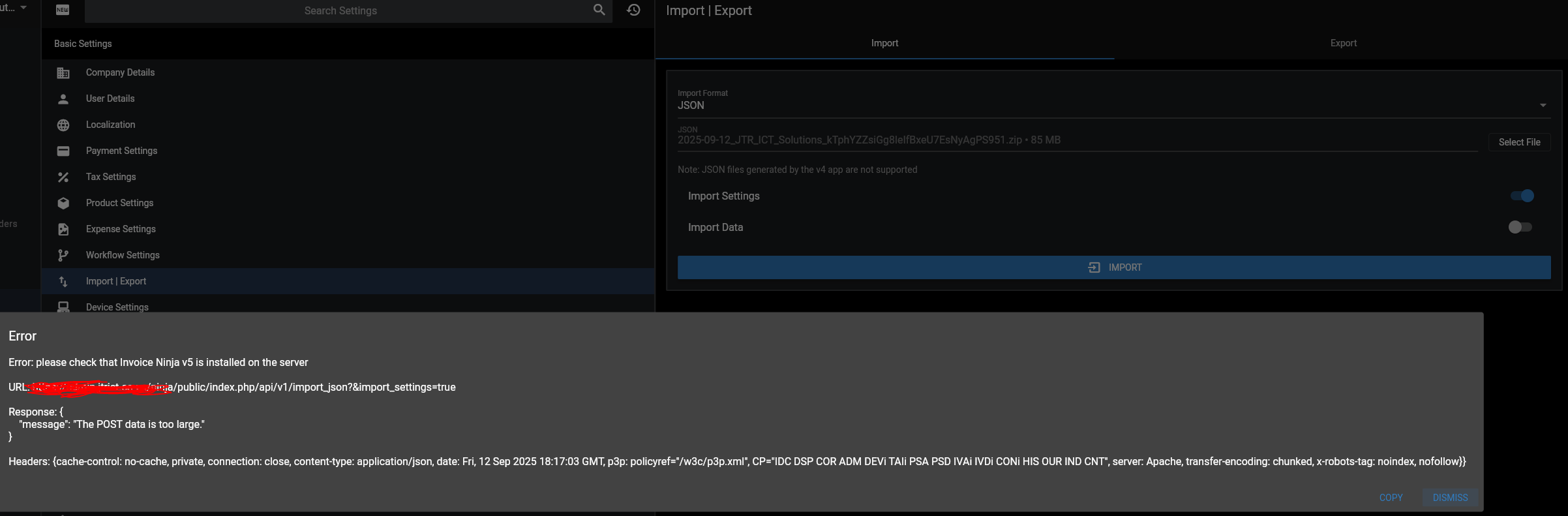

Yes I am, and I do select Import settings only but get that error
