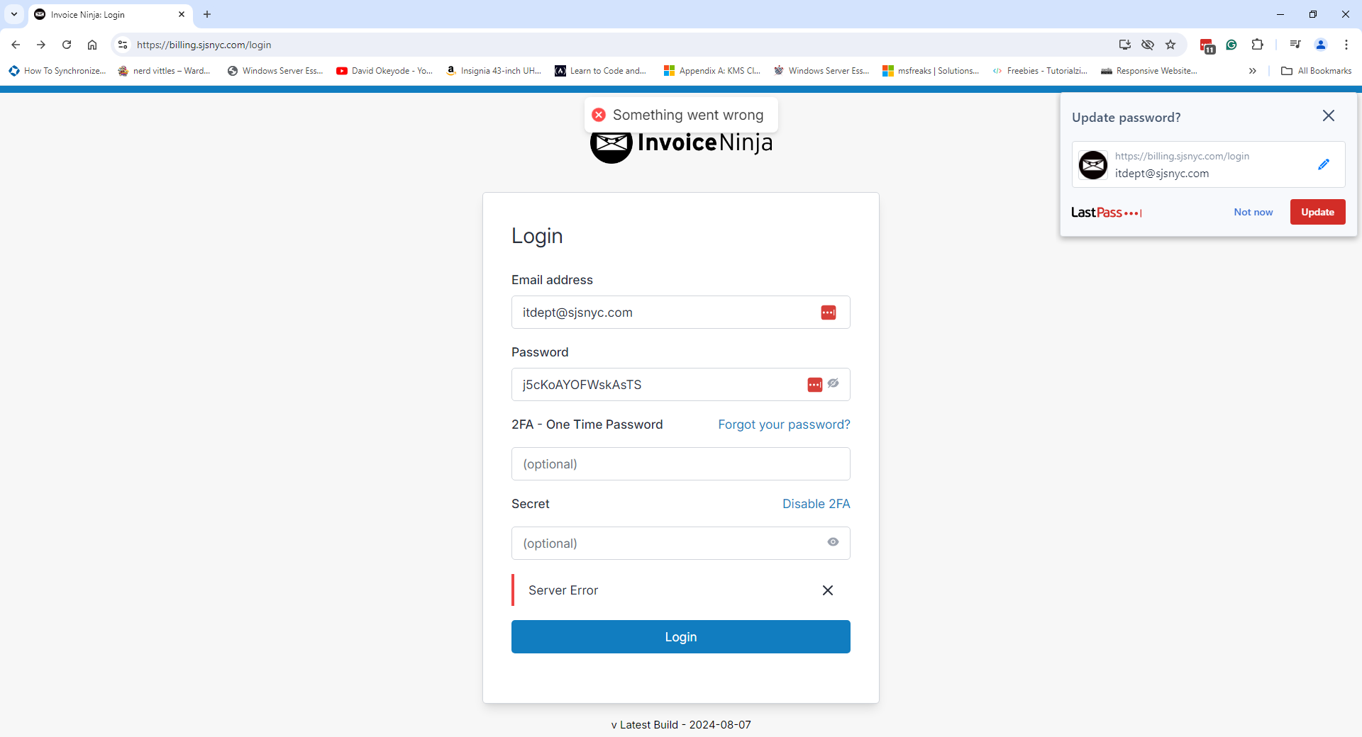

Fatal error: Composer detected issues in your platform: Your Composer dependencies require a PHP version “>= 8.2.0”. You are running 8.1.29. in /var/www/invoiceninja/vendor/composer/platform_check.php on line 28
tried uploading the dump of the db to a new install and I get this
Desperate right now any help is greatly appreciated.

Can you please share the most recent information from the log? It will be found at the very bottom of the log. That indicates the information you shared is one week old. It is more helpful to have the logs from when you were trying to do this.
This indicates that potentially more than one database user was trying to access the same field at the same time to perform the same action and this error is a result.
*Can you please share what your apache config file looks like?
When you share it, please start a new line and select the </> button in the editor and place the information below the back ticks that look like this ```. Make sure there are also back ticks on the final line of the code to close it (they should automatically show up). This makes it much easier to read, when sharing code.
That log is the last entry, even after rebooting this is what shows up.
