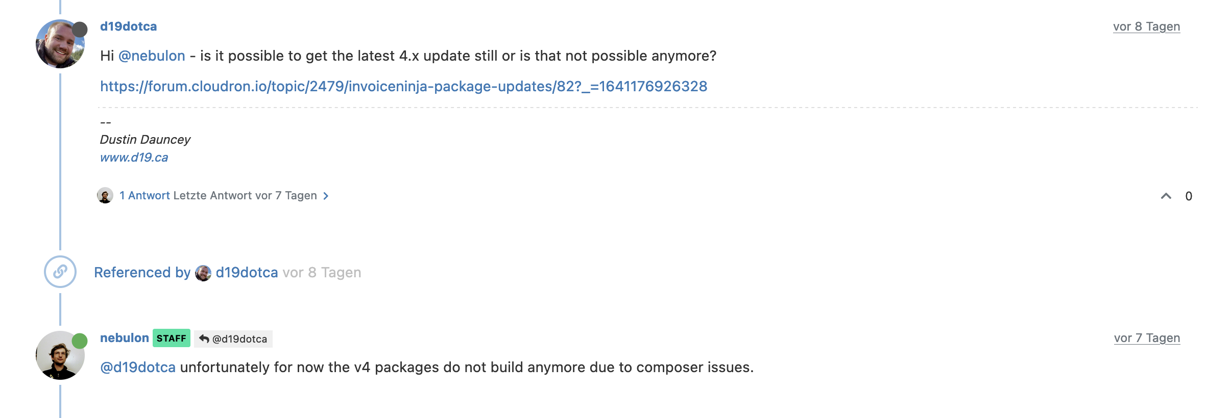

Thank you (and nebulon!) for working together. They pushed out an update very quickly.
Sadly, my issue persists even after updating to v4.5.47.
