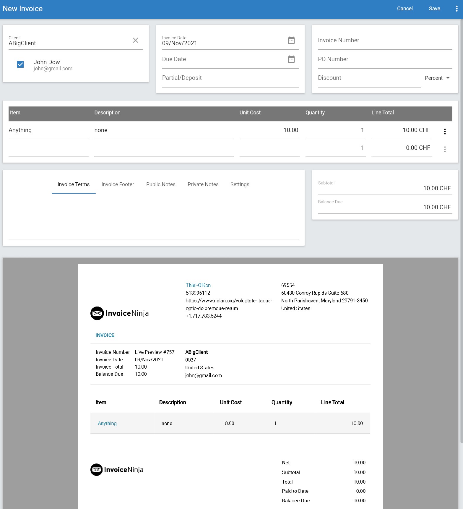

I’ve got a similar issue with CHF (Swiss Franc is my default currency).
If I select “Symbol” then no currency is displayed on the pdf, and if I select “Code” then the CHF is displayed before the amount.
Could you make one of them display the “CHF” after the amount ?
(I’ve made those screenshot on demo.invoiceninja.com)
With “Symbol”
With “Code”
Kind regards
Vincent

I believe this is related to the country the client is in, we perform switching if the country matches the following.
You can adjust this yourself by toggling the swap_currency_symbol in the countries table for the country you wish.
