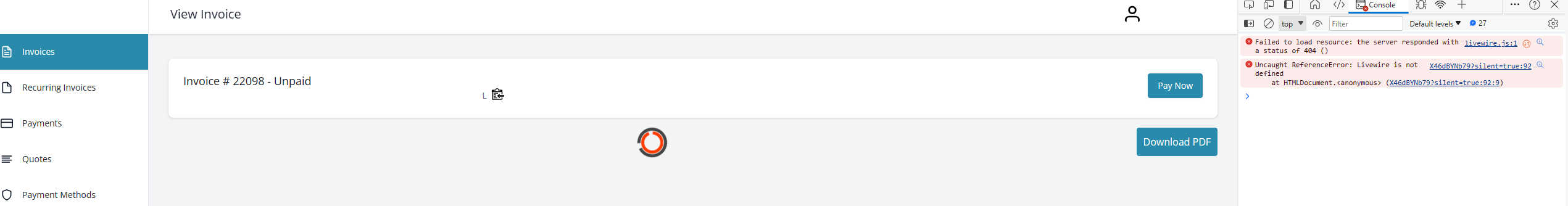

Console log in invoice view for client showing livewire.js 404 so invoice fails to load

in the network tab, what is the full path to the livewire.js file?
the full path is https://{mydomain}/livewire/livewire.js (giving 404)
