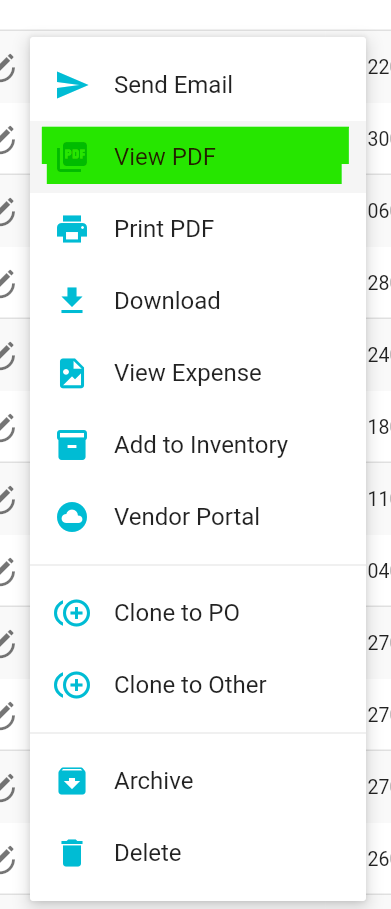

Ever since I upgraded to v5.6.3-C120 the option to view saved pdf’s like supplier invoices etc… from the expense screen is not there, it only has an option to download the pdf …
It used to be like this

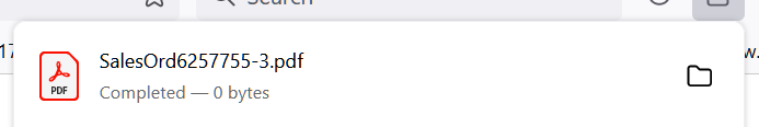

Then when it is downloaded the pdf file size is 0 bytes.

Furthermore when I try to download the document it’s size is 0 Bytes…
see below
So I cannot see it anyway

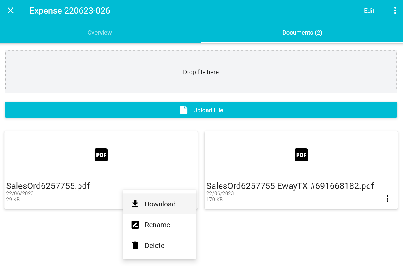

Now here is question for you, when you attach a file to a a record, in this case it is “Expense 220623-026”
Where does INV-Ninj store that record? . From what I understand it should be on the machine that is running the application in the mysql db … true ?
see below: I just clicked on the "“Upload File” radio button… Then it asked me to navigate to the file I want o upload, then I choose the file it says file uploaded and it appears as an attached document in the record … … where does it store that file ?
Now when I try do download the file I stored it goes and looks for it in the local downloads folder … and it downloads an empty file …

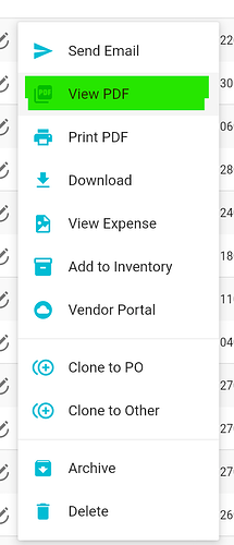

Just updated to v5.6.17-C123 and it seems that there is no option to view
Is there a later release ?
regards
George V
The view option is currently only for images, we’ll look into also supporting PDFs.
