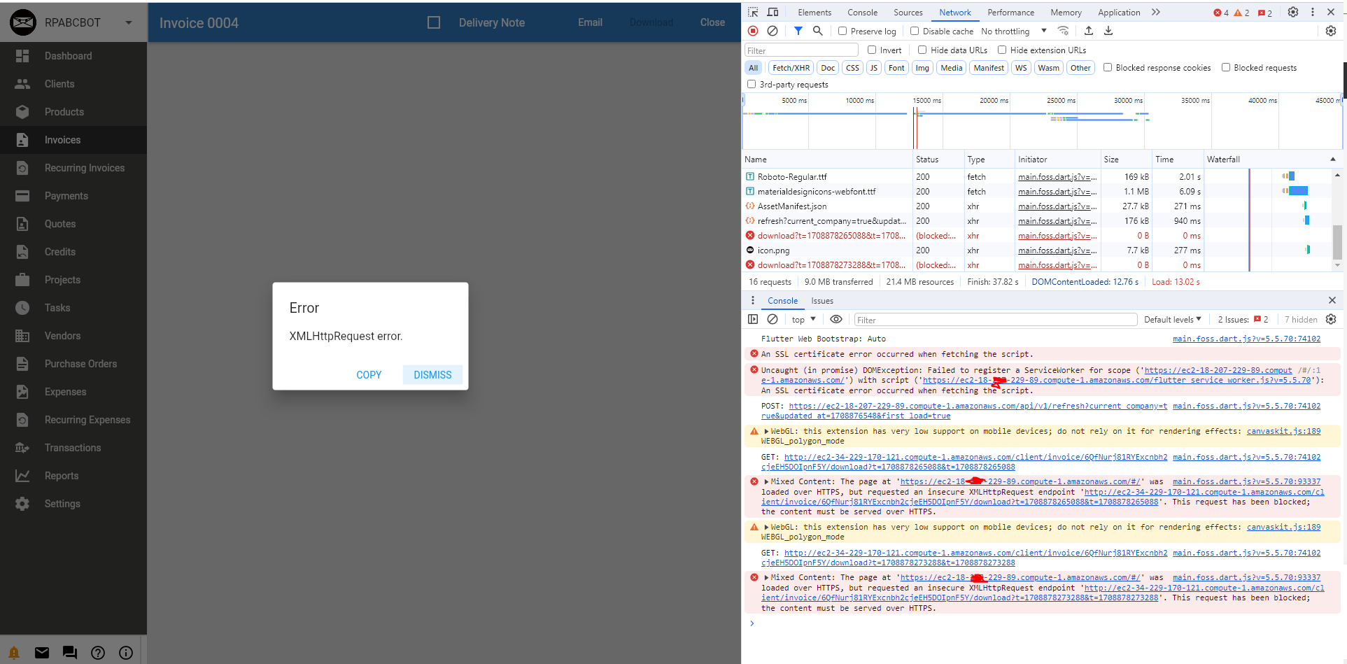

After creating an invoice, if I click the “View PDF” , it gets an error
XMLHttpRequest error.
The preview of the PDF in the window shows the PDF file.

It may help to change to the hosted_ninja PDF generator.
Being very new to this app, what PDF generator can be used and how would it be set up?
Using hosted_ninja doesn’t require any setup
Do you mean the Free Plan at https://invoicing.co/
or
Download the app from https://www.invoiceninja.org/
In your .env file above you have this line:
PDF_GENERATOR=snappdf
I’m suggesting you change it to:
PDF_GENERATOR=hosted_ninja

Thanks, that now works.
