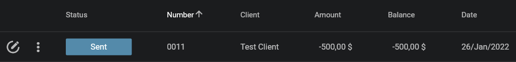

- Let’s say I create a similar negative invoice for the negative amount of the first invoice in order to cancel it, but this time I mark it as sent instead of marking it as paid directly. The client Balance is now -$500.
- If I try to mark it as paid from the “Sent” status, I get that popup:
But the invoice status doesn’t actually update and it’s stuck at “Sent”:
