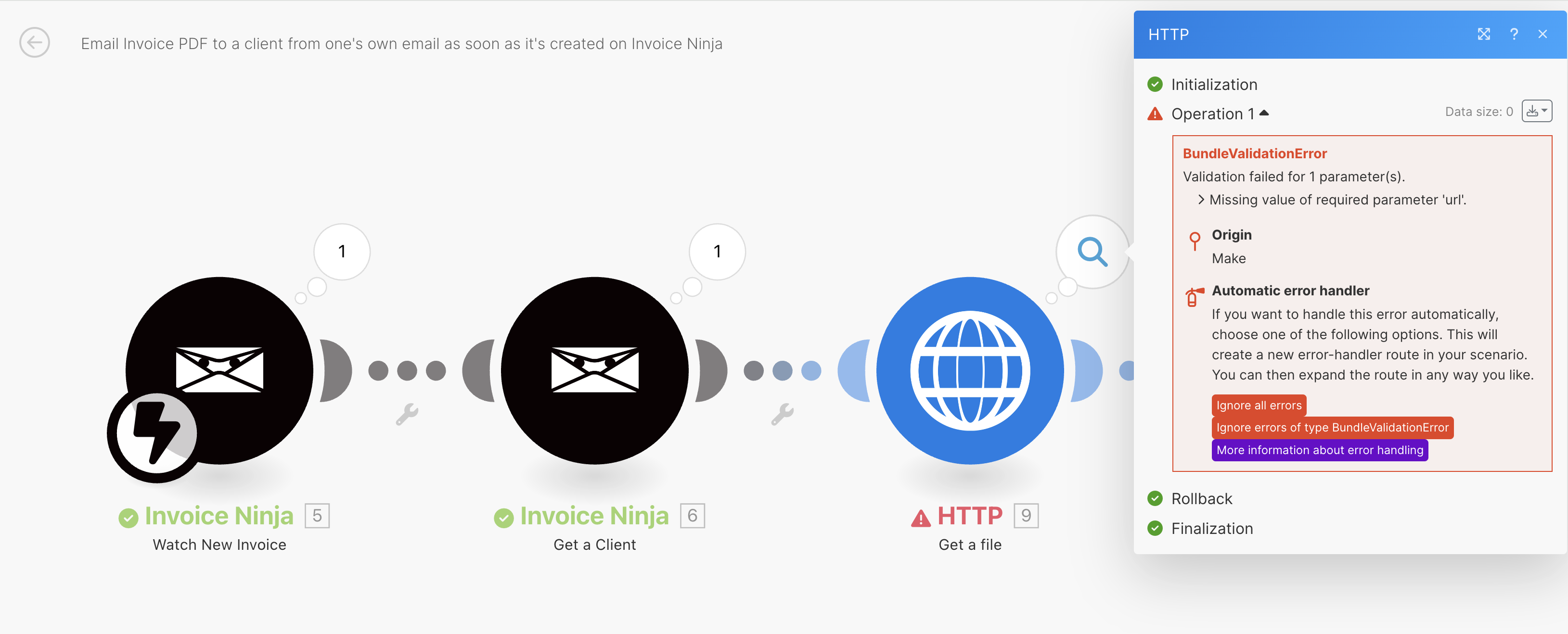

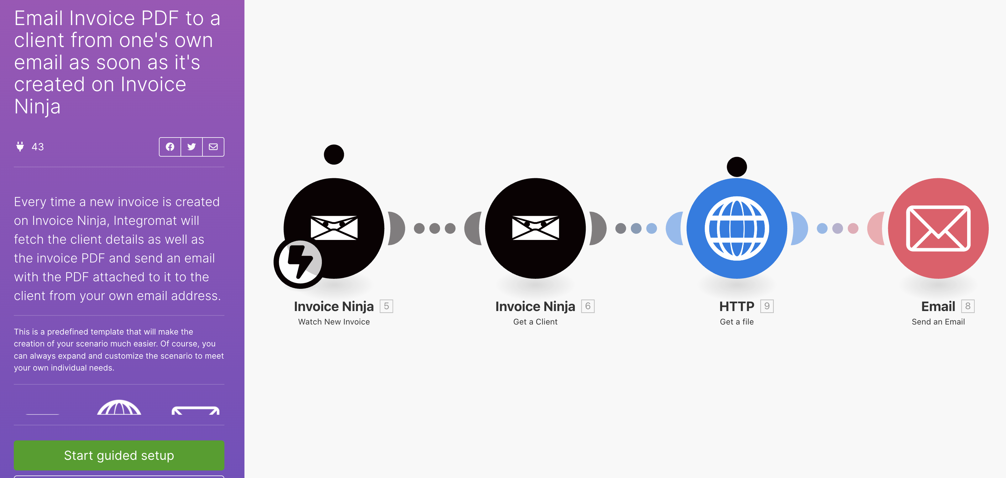

Hi I’d like to send invoices for two automation setups I have using Make.com
There is even a template on make.com for doing this but it doesn’t seem to work.
(Can’t add the link because I’m a new user it says)
Does anyone have an idea on how to fix either the template from make or use another way?
Thanks!
hillel
December 21, 2023, 11:58am
2

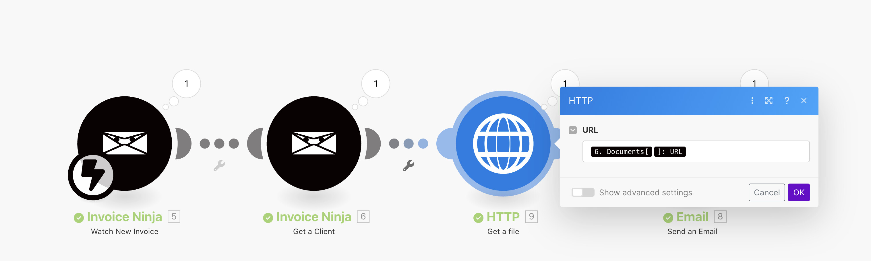

Are you seeing a specific error?
Also, which version of the app are you using?
Hi Hillel,
This is the error I’m getting in Make
No Idea about the version, where do I check this?
hillel
December 21, 2023, 12:37pm
4
Have you supplied a value for the URL?
If you’re using v5 the URL is https://invoicing.co
I used the mapped value straight from the template

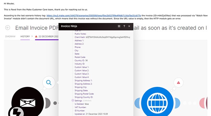

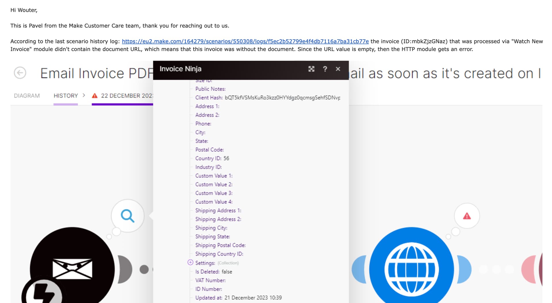

Just checked the webhook log and the file itself is just not available it seems. The link to the portal is there but no files. So I think it has something to do with how the PDF is attached to the record. I’ll see what Make has to say about it

I just received a reply from make.com . The PDF is just not showing up with the other data. Any Idea on how to get it to show up and be downloadable?

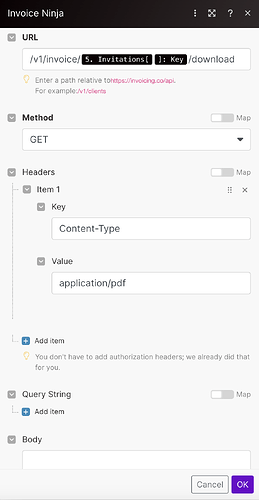

I think you may be confusing the documents array (which will be empty) and the invoice PDF.
That’s possible however I’ve been looking for the PDF in all the other fields and it’s just not anywhere to be found. Maybe I can try to use a custom API call Any idea what Key Value pair I should be looking for to get the PDF?
hillel
January 2, 2024, 11:15am
15
That should be possible, I suggest using the browser console in the web app to see a sample API request.

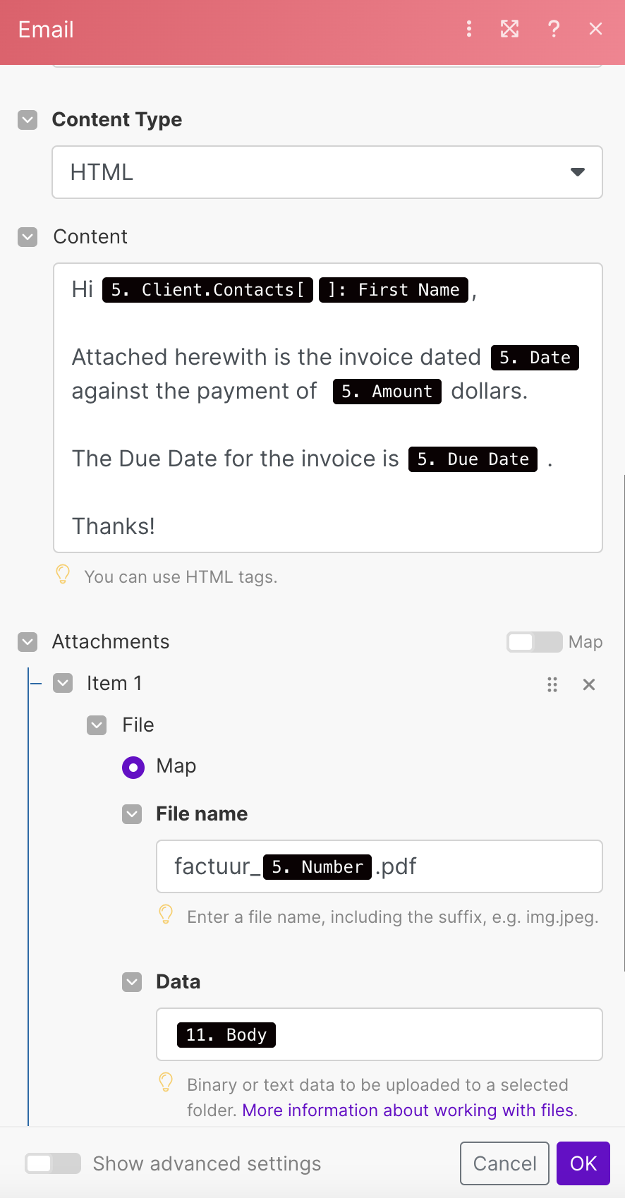

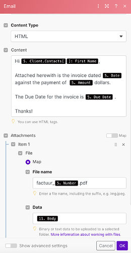

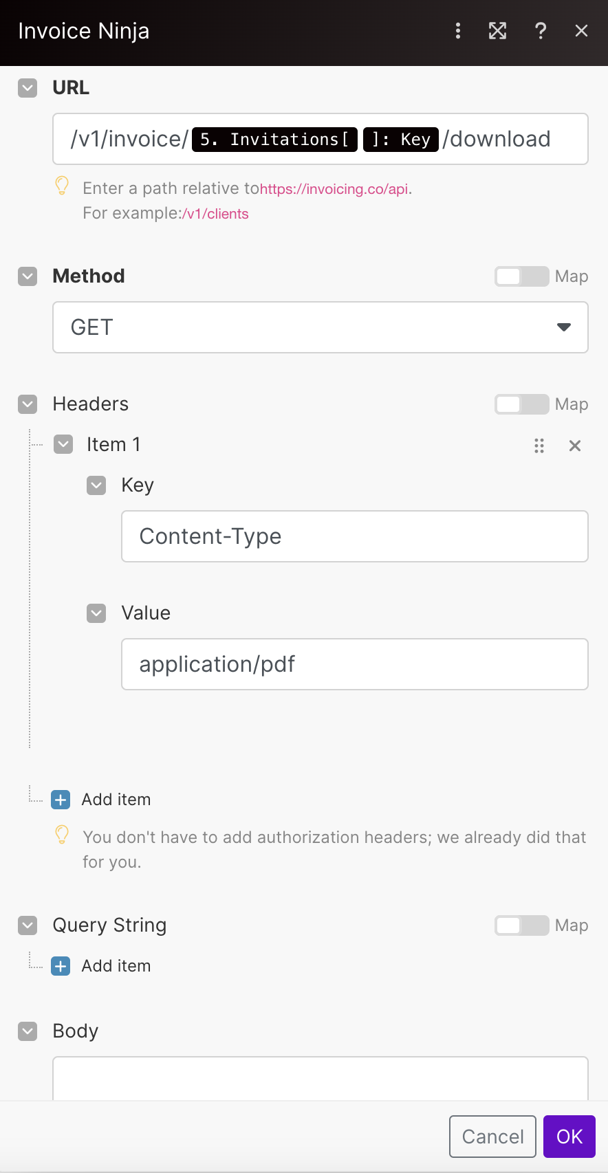

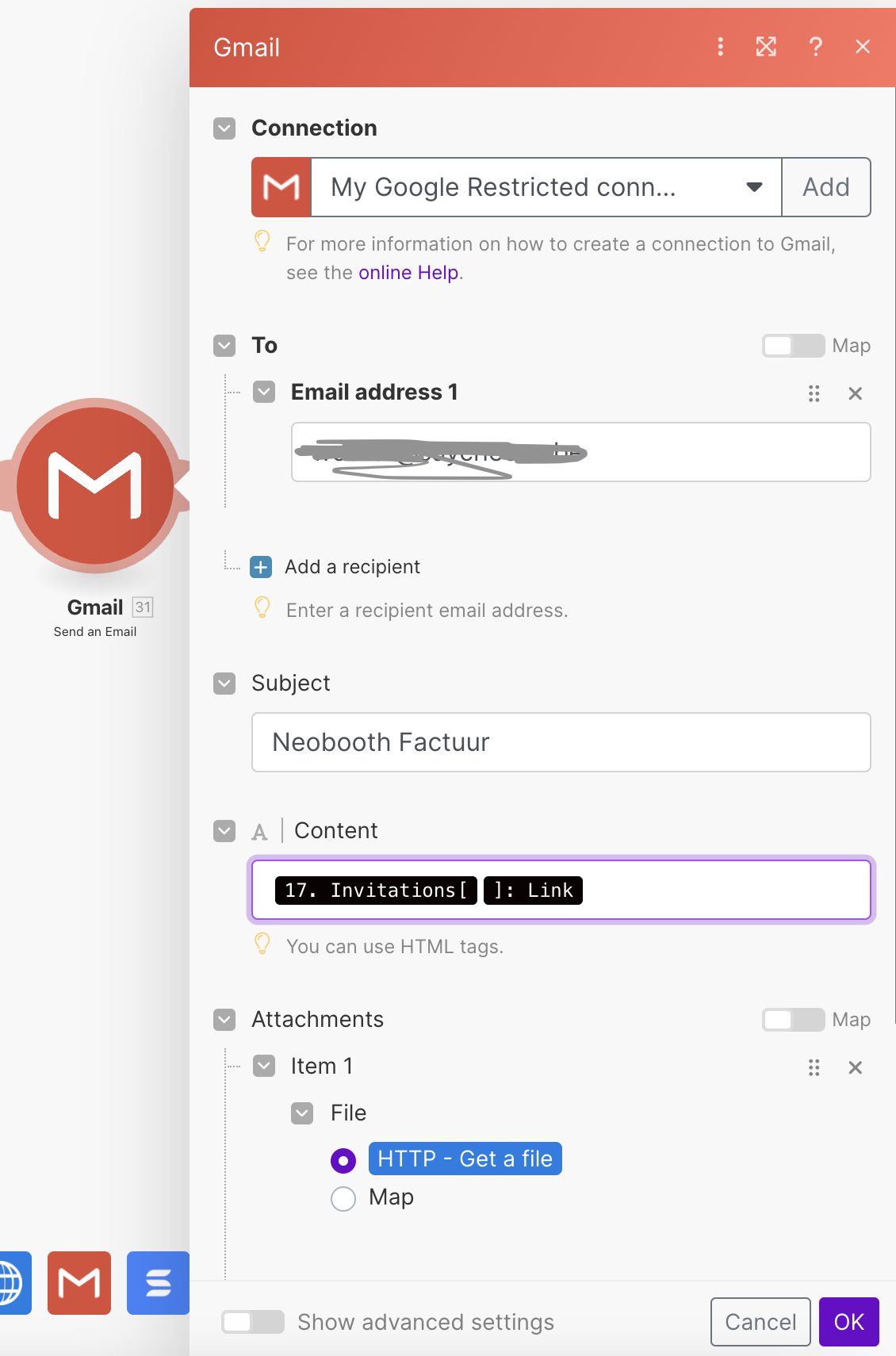

We found the fix after much trial and error by using the following settings
We now are able to get the PDF file and add it to a mail directly without using the portal.
