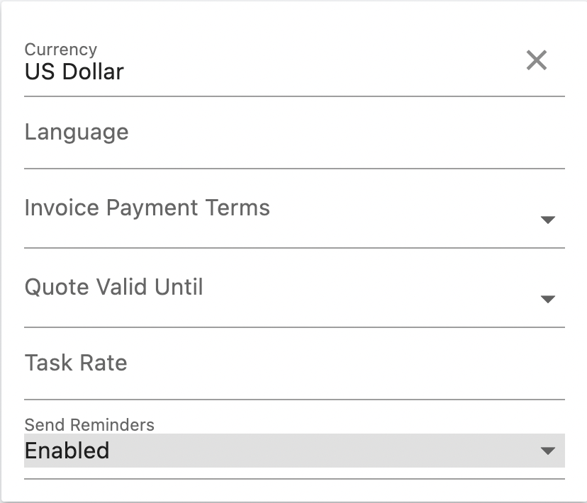

I have also gone through and confirmed all client accounts have reminders enabled.

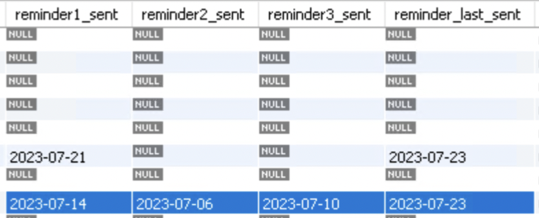

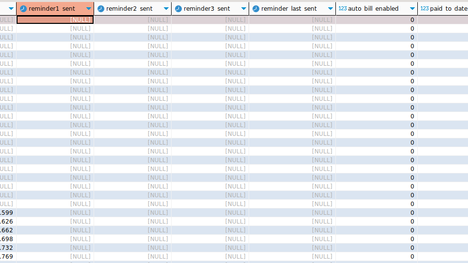

In there Invoices table, check these columns:
If they have dates inserted on the reminders that you are expecting to have sent, then it means they have either already been sent manually so will not be triggered for another send when the automated ones are assessed for sending.
There are dates inserted for one of the invoices, but the other invoice is listed as null(directly above the bottom). Neither of them were sent/ delivered. I just made a new test client with a test invoice, and it should send something out tomorrow. All the values for the future invoice are listed as null.

This will give more details when the reminder job runs. Also, just confirm that the next_send_date for the invoice is primed for tomorrow.
@david
I have enabled expanded logging and it appears that the invoices are primed. I have one that should go out tomorrow and one that should go out the day after. I will keep you updated. Thanks!
