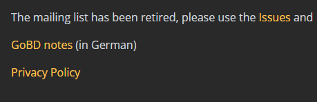

I’ve heard good things about https://www.mailpiler.org/ and I’ll likely be standing this up myself.
FYI is does have a statement regarding GoBD for you: GoBD notes (in German)
