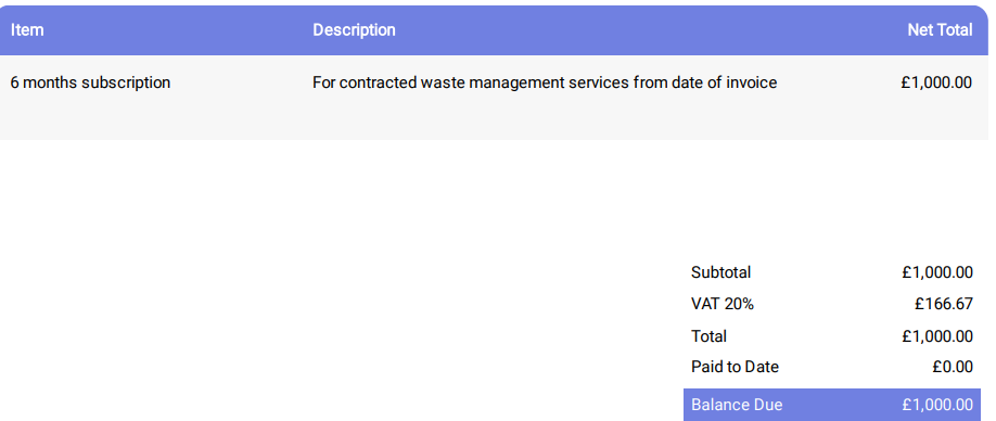

I am creating invoice via API, adding tax in the invoice, in line item i am passing the cost.
for example my amount is 100 inclusive VAT. when i send it, its again calculating vat on 100 so total is incorrect. If i deduct the amount of tax like 100 -20= 80, if i pass 80 its calculating VAT on it, so than also total is incorrect.
just want to check if there is any parameter where in the json where i can pass the tax amount so it doesn’t calculate the tax again, like i pass the 80 in the cost and 20 in the tax. so its shows 100 correct value in the PDF.
You can set uses_inclusive_taxes to true in the request to have the app consider the taxes as inclusive.
I added uses_inclusive_taxes =true, its showing the tax. but not adding
requirement is like subtotal = 800
vat 20% = 200
total =1000
Sorry, that isn’t supported. If the cost is 800 and the tax is 20% then the tax amount would be 160 not 200, assuming you use exclusive taxes.
