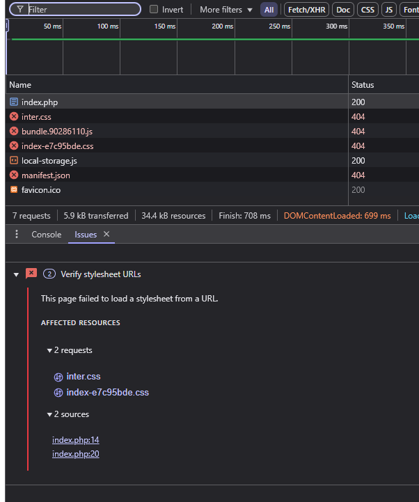

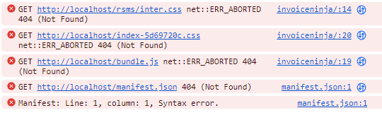

I have already tried various ways to get InvoiceNinja v5 working, thru the local installation and with ubuntu. but I always see a white screen after the setup screen. the logs do not show any error messages, only with the devtool can I find these error messages:
GET http://localhost/rsms/inter.css net::ERR_ABORTED 404 (Not Found) invoiceninja/:20
   GET http://localhost/index-5d69720c.css net::ERR_ABORTED 404 (Not Found) invoiceninja/:19
   GET http://localhost/bundle.js net::ERR_ABORTED 404 (Not Found) manifest.json:1
   GET http://localhost/manifest.json 404 (Not Found) manifest.json:1 Manifest: Line: 1, column: 1, Syntax error.

@jesse Is there anything in your laravel.log? Nothing in your web logs for nginx or Apache?
That could be indicating that either IN was not installed correctly, or that your web user does not have correct permissions to access those directories/assets.

It seems like an issue with loading the js files ?
