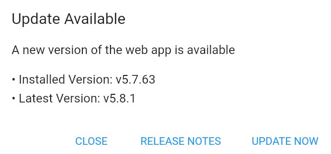

I did try manually updating by unzipping the latest version and one of the puzzling things is I still see an update notice, but only about the web app.
update notification
I’m not sure how the database gets updated if I just unzip things (newbie here, trying it out for the first time so a certain amount of ignorance is to be expected!).
