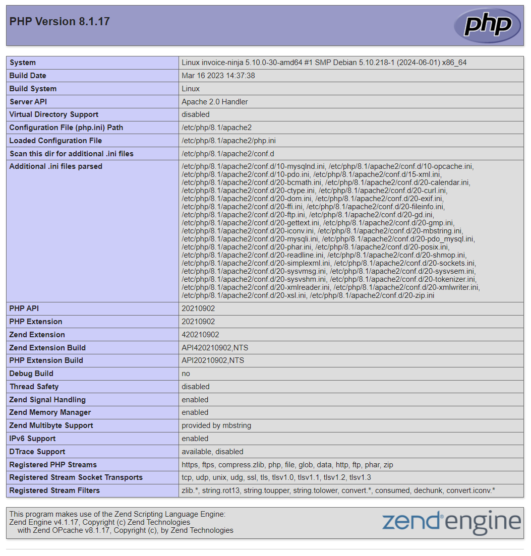

Acefx
June 26, 2024, 12:37pm
7
For sure php is the main problem
I’ve setup a php info page, an indeed the server is running on 8.1 and not in 8.2…
Do you have any idea where can be the conf file to get it running on 8.2 ?
my phpinfo

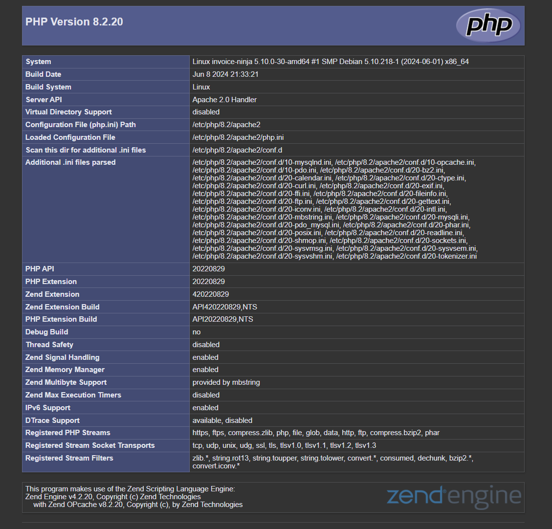

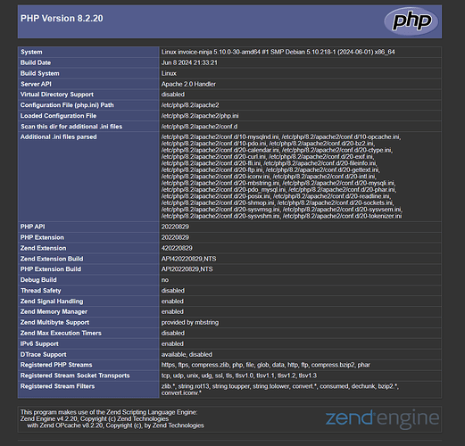

Acefx
June 26, 2024, 1:02pm
8
Ok I’ve figured out how to select Php version on turnkey distribution.
It’s done via Webmin —>Server—>apache webserver—> global —> configure apache modules. then select php8.2 and deselect php8.1
Now when i’m login in i get a server error message. Not the solution but maybe i’m getting close to the resolution
Any through ?

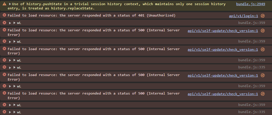

Yes i’ve found it , The permissions seems to be ok
I still have some 500 error every page load
hillel
June 26, 2024, 5:53pm
18
If you’re seeing a 500 error in the app there will be details about the error in either the web server error logs or the app logs in storage/logs.

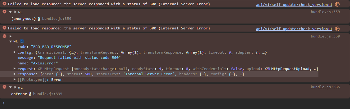

Here the Storage/Log
Laravel.log
[2024-06-26 18:26:29] production.ERROR: file_get_contents(): php_network_getaddresses: getaddrinfo for pdf.invoicing.co failed: Temporary failure in name resolution {"userId":1,"exception":"[object] (ErrorException(code: 0): file_get_contents(): php_network_getaddresses: getaddrinfo for pdf.invoicing.co failed: Temporary failure in name resolution at /var/www/invoiceninja/app/Http/Controllers/SelfUpdateController.php:183)
[stacktrace]
#0 /var/www/invoiceninja/vendor/laravel/framework/src/Illuminate/Foundation/Bootstrap/HandleExceptions.php(256): Illuminate\\Foundation\\Bootstrap\\HandleExceptions->handleError()
#1 [internal function]: Illuminate\\Foundation\\Bootstrap\\HandleExceptions->Illuminate\\Foundation\\Bootstrap\\{closure}()
#2 /var/www/invoiceninja/app/Http/Controllers/SelfUpdateController.php(183): file_get_contents()
#3 /var/www/invoiceninja/vendor/laravel/framework/src/Illuminate/Routing/Controller.php(54): App\\Http\\Controllers\\SelfUpdateController->checkVersion()
#4 /var/www/invoiceninja/vendor/laravel/framework/src/Illuminate/Routing/ControllerDispatcher.php(43): Illuminate\\Routing\\Controller->callAction()
#5 /var/www/invoiceninja/vendor/sentry/sentry-laravel/src/Sentry/Laravel/Tracing/Routing/TracingControllerDispatcherTracing.php(21): Illuminate\\Routing\\ControllerDispatcher->dispatch()
#6 /var/www/invoiceninja/vendor/sentry/sentry-laravel/src/Sentry/Laravel/Tracing/Routing/TracingRoutingDispatcher.php(17): Sentry\\Laravel\\Tracing\\Routing\\TracingControllerDispatcherTracing->Sentry\\Laravel\\Tracing\\Routing\\{closure}()
#7 /var/www/invoiceninja/vendor/sentry/sentry-laravel/src/Sentry/Laravel/Tracing/Routing/TracingControllerDispatcherTracing.php(20): Sentry\\Laravel\\Tracing\\Routing\\TracingRoutingDispatcher->wrapRouteDispatch()
#8 /var/www/invoiceninja/vendor/laravel/framework/src/Illuminate/Routing/Route.php(260): Sentry\\Laravel\\Tracing\\Routing\\TracingControllerDispatcherTracing->dispatch()
#9 /var/www/invoiceninja/vendor/laravel/framework/src/Illuminate/Routing/Route.php(206): Illuminate\\Routing\\Route->runController()
#10 /var/www/invoiceninja/vendor/laravel/framework/src/Illuminate/Routing/Router.php(806): Illuminate\\Routing\\Route->run()
#11 /var/www/invoiceninja/vendor/laravel/framework/src/Illuminate/Pipeline/Pipeline.php(144): Illuminate\\Routing\\Router->Illuminate\\Routing\\{closure}()
#12 /var/www/invoiceninja/vendor/laravel/framework/src/Illuminate/Routing/Middleware/ThrottleRequests.php(124): Illuminate\\Pipeline\\Pipeline->Illuminate\\Pipeline\\{closure}()
#13 /var/www/invoiceninja/vendor/laravel/framework/src/Illuminate/Routing/Middleware/ThrottleRequests.php(89): Illuminate\\Routing\\Middleware\\ThrottleRequests->handleRequestUsingNamedLimiter()
#14 /var/www/invoiceninja/vendor/laravel/framework/src/Illuminate/Pipeline/Pipeline.php(183): Illuminate\\Routing\\Middleware\\ThrottleRequests->handle()
#15 /var/www/invoiceninja/app/Http/Middleware/QueryLogging.php(39): Illuminate\\Pipeline\\Pipeline->Illuminate\\Pipeline\\{closure}()
#16 /var/www/invoiceninja/vendor/laravel/framework/src/Illuminate/Pipeline/Pipeline.php(183): App\\Http\\Middleware\\QueryLogging->handle()
#17 /var/www/invoiceninja/vendor/laravel/framework/src/Illuminate/Routing/Middleware/SubstituteBindings.php(50): Illuminate\\Pipeline\\Pipeline->Illuminate\\Pipeline\\{closure}()
#18 /var/www/invoiceninja/vendor/laravel/framework/src/Illuminate/Pipeline/Pipeline.php(183): Illuminate\\Routing\\Middleware\\SubstituteBindings->handle()
#19 /var/www/invoiceninja/app/Http/Middleware/Locale.php(95): Illuminate\\Pipeline\\Pipeline->Illuminate\\Pipeline\\{closure}()
#20 /var/www/invoiceninja/vendor/laravel/framework/src/Illuminate/Pipeline/Pipeline.php(183): App\\Http\\Middleware\\Locale->handle()
#21 /var/www/invoiceninja/app/Http/Middleware/TokenAuth.php(102): Illuminate\\Pipeline\\Pipeline->Illuminate\\Pipeline\\{closure}()
#22 /var/www/invoiceninja/vendor/laravel/framework/src/Illuminate/Pipeline/Pipeline.php(183): App\\Http\\Middleware\\TokenAuth->handle()
#23 /var/www/invoiceninja/app/Http/Middleware/SetDb.php(40): Illuminate\\Pipeline\\Pipeline->Illuminate\\Pipeline\\{closure}()
#24 /var/www/invoiceninja/vendor/laravel/framework/src/Illuminate/Pipeline/Pipeline.php(183): App\\Http\\Middleware\\SetDb->handle()
#25 /var/www/invoiceninja/vendor/laravel/framework/src/Illuminate/Pipeline/Pipeline.php(119): Illuminate\\Pipeline\\Pipeline->Illuminate\\Pipeline\\{closure}()
#26 /var/www/invoiceninja/vendor/laravel/framework/src/Illuminate/Routing/Router.php(805): Illuminate\\Pipeline\\Pipeline->then()
#27 /var/www/invoiceninja/vendor/laravel/framework/src/Illuminate/Routing/Router.php(784): Illuminate\\Routing\\Router->runRouteWithinStack()
#28 /var/www/invoiceninja/vendor/laravel/framework/src/Illuminate/Routing/Router.php(748): Illuminate\\Routing\\Router->runRoute()
#29 /var/www/invoiceninja/vendor/laravel/framework/src/Illuminate/Routing/Router.php(737): Illuminate\\Routing\\Router->dispatchToRoute()
#30 /var/www/invoiceninja/vendor/laravel/framework/src/Illuminate/Foundation/Http/Kernel.php(200): Illuminate\\Routing\\Router->dispatch()
#31 /var/www/invoiceninja/vendor/laravel/framework/src/Illuminate/Pipeline/Pipeline.php(144): Illuminate\\Foundation\\Http\\Kernel->Illuminate\\Foundation\\Http\\{closure}()
#32 /var/www/invoiceninja/vendor/sentry/sentry-laravel/src/Sentry/Laravel/Http/FlushEventsMiddleware.php(13): Illuminate\\Pipeline\\Pipeline->Illuminate\\Pipeline\\{closure}()
#33 /var/www/invoiceninja/vendor/laravel/framework/src/Illuminate/Pipeline/Pipeline.php(183): Sentry\\Laravel\\Http\\FlushEventsMiddleware->handle()
#34 /var/www/invoiceninja/vendor/sentry/sentry-laravel/src/Sentry/Laravel/Http/SetRequestIpMiddleware.php(45): Illuminate\\Pipeline\\Pipeline->Illuminate\\Pipeline\\{closure}()
#35 /var/www/invoiceninja/vendor/laravel/framework/src/Illuminate/Pipeline/Pipeline.php(183): Sentry\\Laravel\\Http\\SetRequestIpMiddleware->handle()
#36 /var/www/invoiceninja/vendor/sentry/sentry-laravel/src/Sentry/Laravel/Http/SetRequestMiddleware.php(31): Illuminate\\Pipeline\\Pipeline->Illuminate\\Pipeline\\{closure}()
#37 /var/www/invoiceninja/vendor/laravel/framework/src/Illuminate/Pipeline/Pipeline.php(183): Sentry\\Laravel\\Http\\SetRequestMiddleware->handle()
#38 /var/www/invoiceninja/vendor/livewire/livewire/src/Features/SupportDisablingBackButtonCache/DisableBackButtonCacheMiddleware.php(19): Illuminate\\Pipeline\\Pipeline->Illuminate\\Pipeline\\{closure}()
#39 /var/www/invoiceninja/vendor/laravel/framework/src/Illuminate/Pipeline/Pipeline.php(183): Livewire\\Features\\SupportDisablingBackButtonCache\\DisableBackButtonCacheMiddleware->handle()
#40 /var/www/invoiceninja/app/Http/Middleware/Cors.php(24): Illuminate\\Pipeline\\Pipeline->Illuminate\\Pipeline\\{closure}()
#41 /var/www/invoiceninja/vendor/laravel/framework/src/Illuminate/Pipeline/Pipeline.php(183): App\\Http\\Middleware\\Cors->handle()
#42 /var/www/invoiceninja/vendor/laravel/framework/src/Illuminate/Http/Middleware/TrustProxies.php(57): Illuminate\\Pipeline\\Pipeline->Illuminate\\Pipeline\\{closure}()
#43 /var/www/invoiceninja/vendor/laravel/framework/src/Illuminate/Pipeline/Pipeline.php(183): Illuminate\\Http\\Middleware\\TrustProxies->handle()
#44 /var/www/invoiceninja/vendor/laravel/framework/src/Illuminate/Foundation/Http/Middleware/TransformsRequest.php(21): Illuminate\\Pipeline\\Pipeline->Illuminate\\Pipeline\\{closure}()
#45 /var/www/invoiceninja/vendor/laravel/framework/src/Illuminate/Foundation/Http/Middleware/ConvertEmptyStringsToNull.php(31): Illuminate\\Foundation\\Http\\Middleware\\TransformsRequest->handle()
#46 /var/www/invoiceninja/vendor/laravel/framework/src/Illuminate/Pipeline/Pipeline.php(183): Illuminate\\Foundation\\Http\\Middleware\\ConvertEmptyStringsToNull->handle()
#47 /var/www/invoiceninja/vendor/laravel/framework/src/Illuminate/Foundation/Http/Middleware/TransformsRequest.php(21): Illuminate\\Pipeline\\Pipeline->Illuminate\\Pipeline\\{closure}()
#48 /var/www/invoiceninja/vendor/laravel/framework/src/Illuminate/Foundation/Http/Middleware/TrimStrings.php(51): Illuminate\\Foundation\\Http\\Middleware\\TransformsRequest->handle()
#49 /var/www/invoiceninja/vendor/laravel/framework/src/Illuminate/Pipeline/Pipeline.php(183): Illuminate\\Foundation\\Http\\Middleware\\TrimStrings->handle()
#50 /var/www/invoiceninja/vendor/laravel/framework/src/Illuminate/Http/Middleware/ValidatePostSize.php(27): Illuminate\\Pipeline\\Pipeline->Illuminate\\Pipeline\\{closure}()
#51 /var/www/invoiceninja/vendor/laravel/framework/src/Illuminate/Pipeline/Pipeline.php(183): Illuminate\\Http\\Middleware\\ValidatePostSize->handle()
#52 /var/www/invoiceninja/vendor/laravel/framework/src/Illuminate/Foundation/Http/Middleware/PreventRequestsDuringMaintenance.php(110): Illuminate\\Pipeline\\Pipeline->Illuminate\\Pipeline\\{closure}()
#53 /var/www/invoiceninja/vendor/laravel/framework/src/Illuminate/Pipeline/Pipeline.php(183): Illuminate\\Foundation\\Http\\Middleware\\PreventRequestsDuringMaintenance->handle()
#54 /var/www/invoiceninja/vendor/sentry/sentry-laravel/src/Sentry/Laravel/Tracing/Middleware.php(97): Illuminate\\Pipeline\\Pipeline->Illuminate\\Pipeline\\{closure}()
#55 /var/www/invoiceninja/vendor/laravel/framework/src/Illuminate/Pipeline/Pipeline.php(183): Sentry\\Laravel\\Tracing\\Middleware->handle()
#56 /var/www/invoiceninja/vendor/laravel/framework/src/Illuminate/Pipeline/Pipeline.php(119): Illuminate\\Pipeline\\Pipeline->Illuminate\\Pipeline\\{closure}()
#57 /var/www/invoiceninja/vendor/laravel/framework/src/Illuminate/Foundation/Http/Kernel.php(175): Illuminate\\Pipeline\\Pipeline->then()
#58 /var/www/invoiceninja/vendor/laravel/framework/src/Illuminate/Foundation/Http/Kernel.php(144): Illuminate\\Foundation\\Http\\Kernel->sendRequestThroughRouter()
#59 /var/www/invoiceninja/public/index.php(56): Illuminate\\Foundation\\Http\\Kernel->handle()
#60 {main}
hillel
June 26, 2024, 6:57pm
20
This error looks related to generating the PDF, are you seeing other problems in the app?
I suggest checking the server can reach pdf.invoicing.co .
