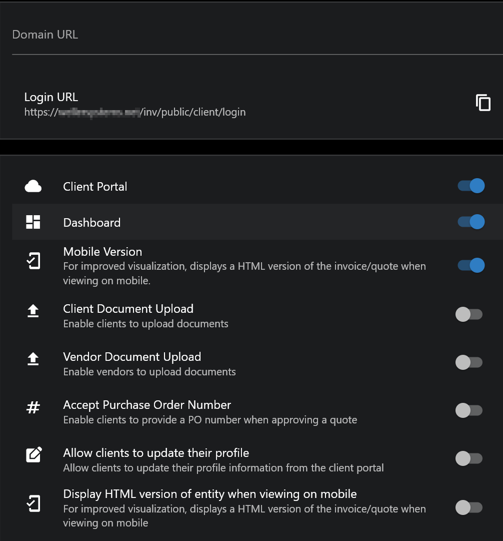

Client portal:

As a test I created a subdomain that points to the current installation and then updated the APP_URL in the .env file to be APP_URL=“https://inv.mydomain.xyz”. I went into Settings >> client portal and the Login URL has been updated to https://inv.mydomain.xyz/client/login (no /inv in the URL anymore). I tested with an existing invoice and it gave me the same result (404 error). However, I created a new invoice and it looks like it is working. No 404 error and I was able to pay the invoice successfully. I confirmed that it’s marked paid in Invoice Ninja and my payment processor has the payment on file.
