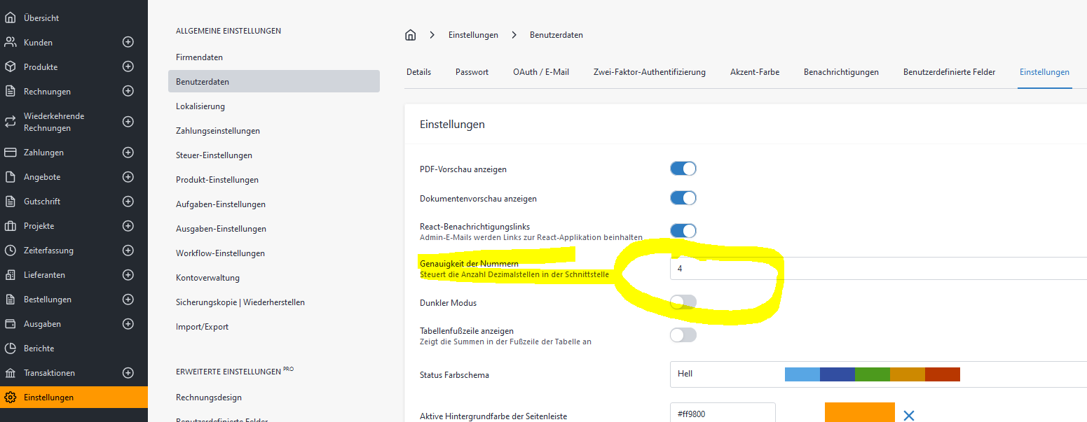

I found this old thread because I had the same problem. The solution is setting the decimal point to 4 on user settings.
