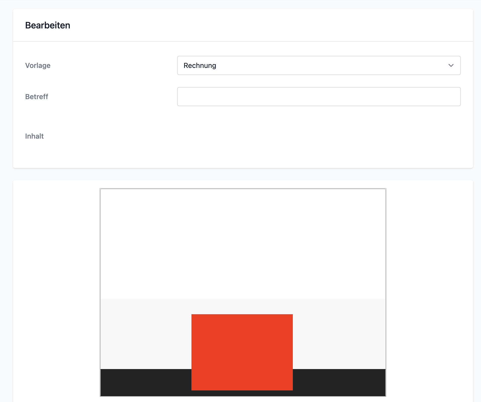

I feel like in the react app I’m seeing wrong values or none while in the flutter app I see the correct information. Here’s an example:
  • The content section doesn’t show a textarea to edit
  • The subject line is actually filled
  • The pdf preview is wrong as well

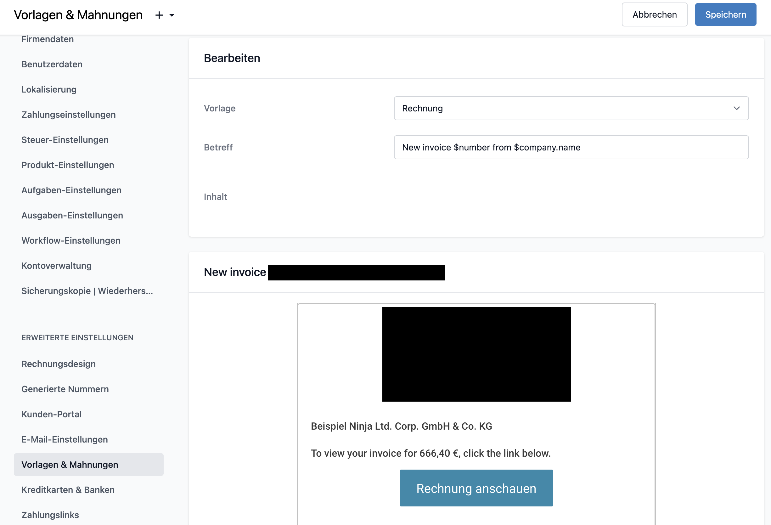

When I navigate to the flutter app and check the settings there, everything looks fine. Now, when navigating back to the react app, I see the default settings with my company logo and name, but the adjusted text and subject line is just not shown.
Sometimes when refreshing the page I’m being shown the correct information and sometimes nothing changes.

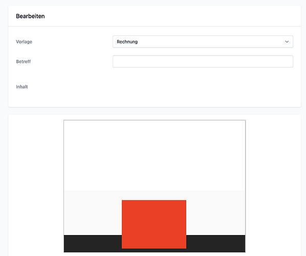

When I just went there to see the console output, I’ve seen the correct values. After I hit refresh, I’ve seen the default settings again. With the above mentioned console logs. After hitting refresh again: No values, like on the first screenshot.
