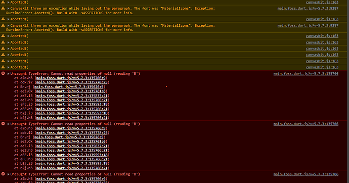

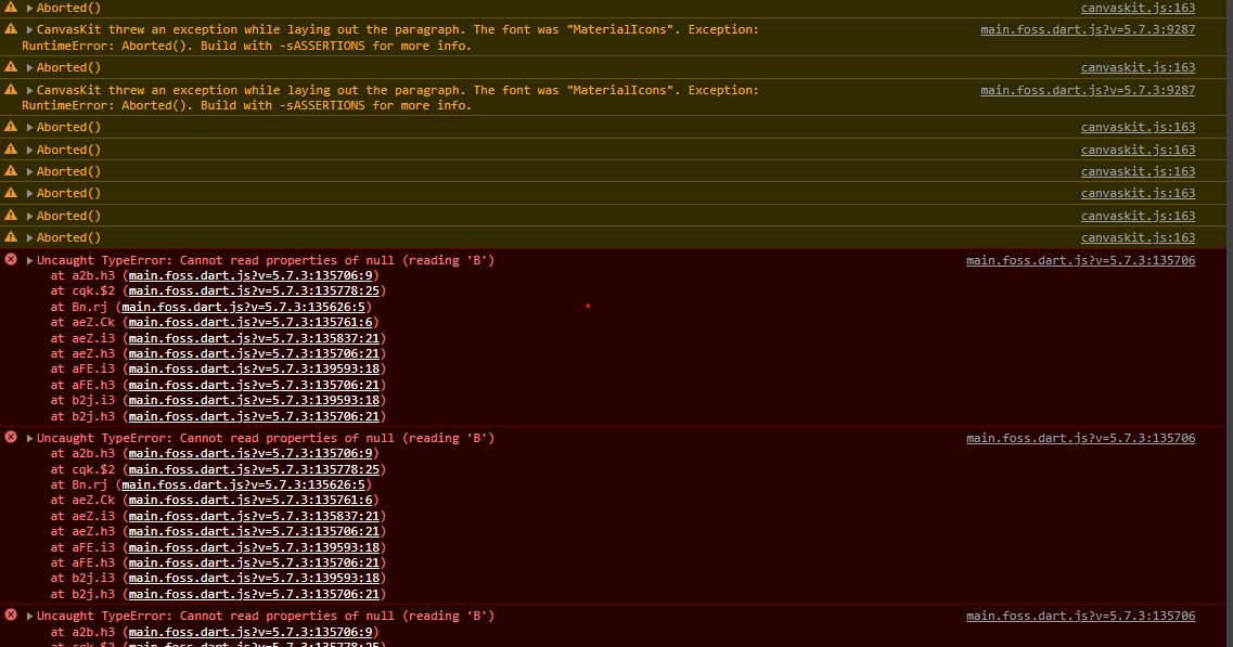

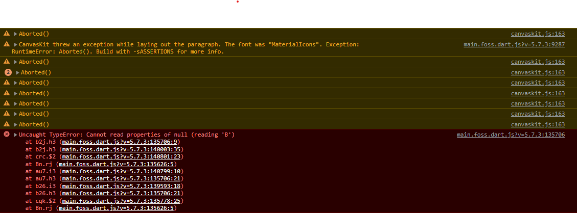

The errors i’m seeing in console are these:
After having the frozen tab open for a while i’m seeing thousands of these errors in console. There are no errors in laravel.log or in my Apache errorlog. This seems to be a javascript problem.

After 5 minutes my console log was 430k rows. I put parts of that in these pastebin links:
This: main.foss.dart.js?v=5.7.3:135706 Uncaught TypeError: Cannot read properties of n - Pastebin.com
And this: canvaskit.js:163 Aborted()Na @ canvaskit.js:163a @ canvaskit.js:232$func35 - Pastebin.com
Do you have any ideas what more i could do to diagnose this?
