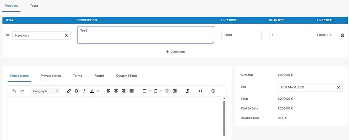

Bug Description:
If you have an invoice with total costs higher or equal to 1,000.00, there are incorrect displays in the reports. However, if you do an export of invoices in the Settings > Import/Export section, the data in the export is correct.

Steps to Reproduce:
Set the localization settings as follows:
Currency: Euro
Currency Format: Code
Language: German
Timezone: Europe/Vienna
Date Format: 01.03.2025
24 Hour Time: On
Rappen Rounding: Off
Decimal Comma: On
First Month of the Year: January
Create an invoice with total costs higher or equal to 1,000.00.

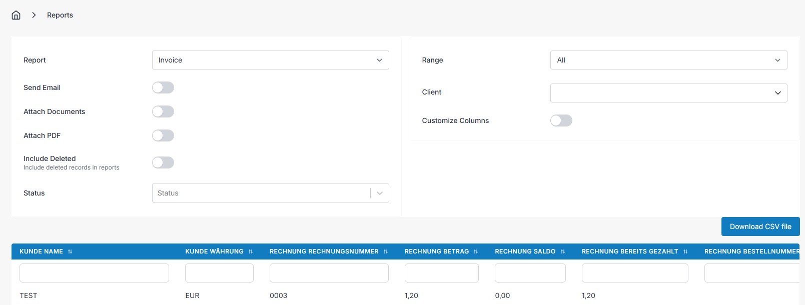

Check the reports to see the incorrect displays.
Go to Settings > Import/Export and export the invoices.
Verify that the data in the export is correct.
In the Report die Invoice as created bevor Shows Cost of 1,20
