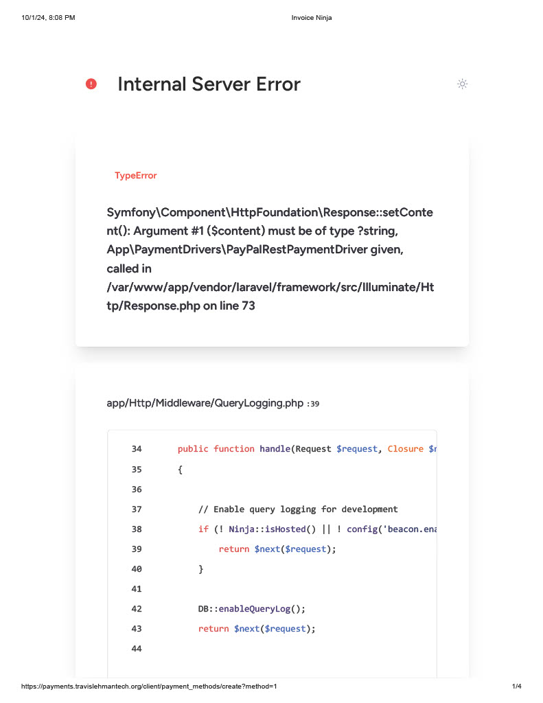

I self host Invoice Ninja v5.10.29-M164 using docker. I set up Paypal REST API initially, and it was working, but something changed in the last week and I’m struggling to understand what. Right now when a user in the client portal attempts to add a credit card the following error displays “500 — Server Error Check storage/logs for more details”
I started the stack with debug on and pulled the attached log, but I’m unsure how to fix it. I can’t tell if it’s something I configured wrong with Paypal or if it’s something in my docker configuration.

That looks odd.
Is the app working otherwise? I am unable to recreate the issue.
Can you advise the PHP version you are using

App is working great otherwise. I actually just set up Stripe API instead last night and it worked. I’ve tried PayPal Rest API and PayPal NVP/SOAP but neither has worked.
PHP 8.2.23

Correct!
Client Portal > Payment Method > Add Payment Method > Credit Card
I created another API ID/Secret on my Paypal Business account, and added a payment gateway in InvoiceNinja (Health check was SUCCESS), then archived any other payment methods, tested and got the same 500 error back again.
Which version are you on? I don’t think payment method is supported until a payment is made with paypal.
