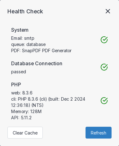

Can you share a screenshot of the health check?
The queue is enabled, is the queue:work cron configured?

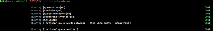

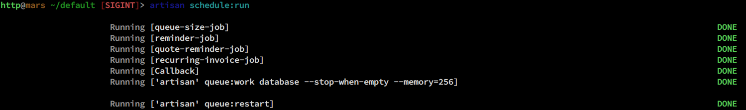

Yes, I originally ran it via a systemd unit, but now it’s running through artisan schedule:run, which took care of it on its own, and it stopped complaining that the cron wasn’t running- it still isn’t delivering emails, though.
I think you’re confusing the cron and the queue, to use the queue you need to add the queue:work cron in addition to schedule:run.
This is what I mean, when I say artisan schedule:run-

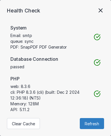

I suggest changing the queue setting to sync in the .env file to disable the queue until you get emails working.
Okay, I did that. Does this mean I don’t have to futz about with ensuring the “Delivery time” matches the next closest hour, and that it’ll just get delivered?
Also, does this mean billing will just, fall into place, when I create a new customer (for now, at least)
Disabling the queue means the app will send the email immediately, rather than create a job in the queue. If the queue is enabled the jobs should be processed within a minute or two.
I suggest checking that the queue is set to sync in the health check and then trying to send an email.
