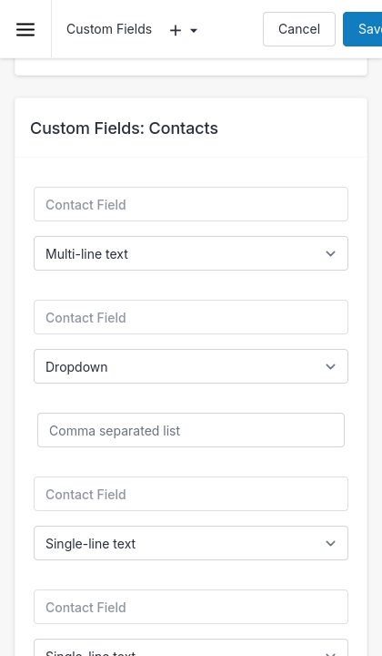

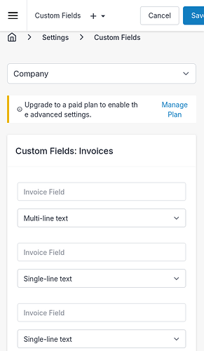

The screenshot shows custom invoice fields, my suggestion was to configure a custom contact field.
Sorry, my misunderstanding there. I think that I found it:
Is it best to use multi-line test or a dropdown?
Where does it the pull in the address from. AFAIK a contact only has an associated email address and prone number.
You’d want to use multiline.
You would specify the address for the contact.
But there is no option to add an address for any contacts, only name, phone, email:
Have you configured the custom contact field?
I have no access to that as I am still testing on the free version before I decide to purchase. Still trying to get a self hosted copy working for testing. Are you able to show screenshots of your method in action?

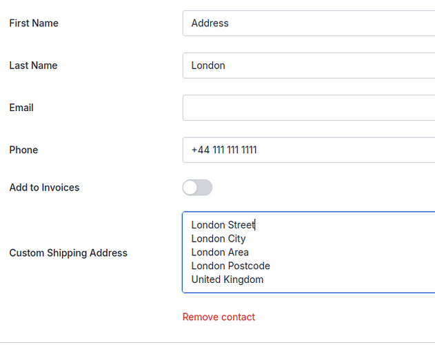

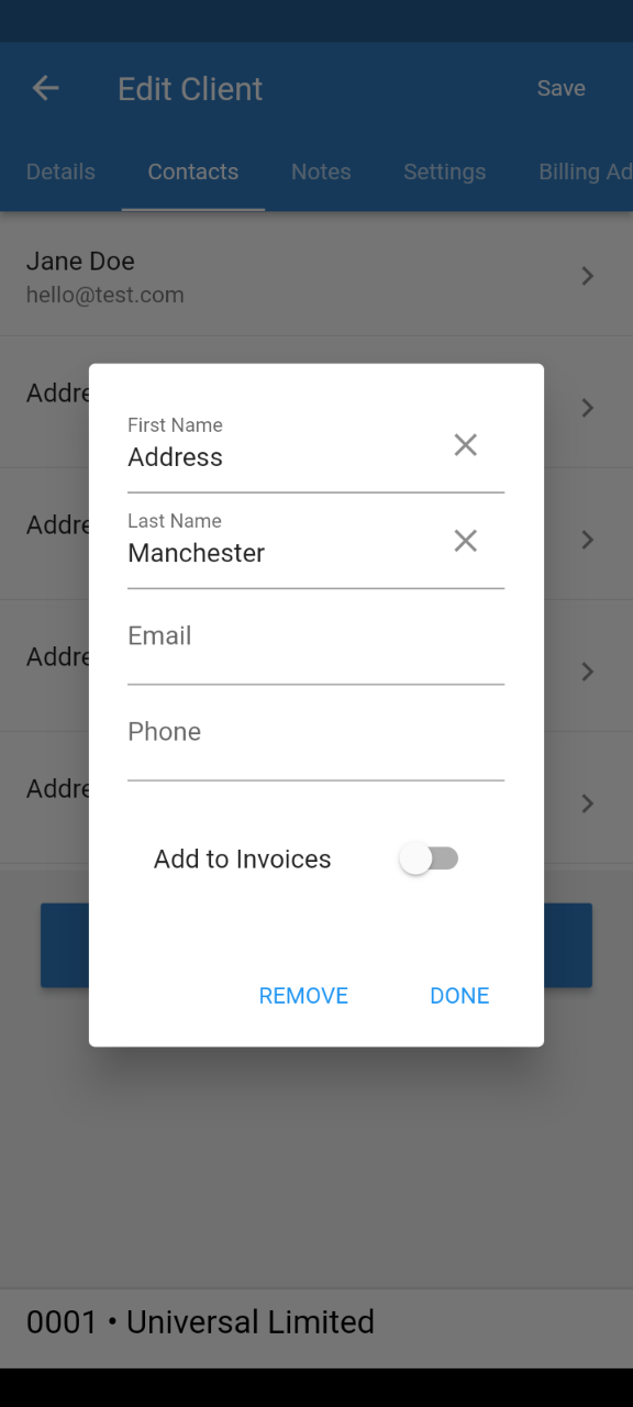

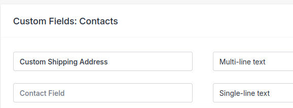

I added a custom contact field:

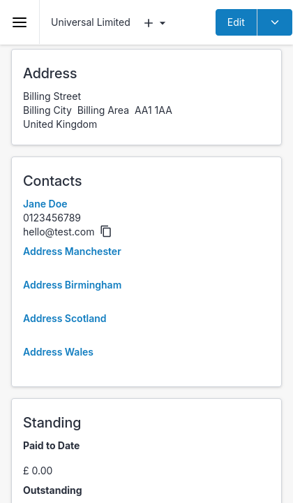

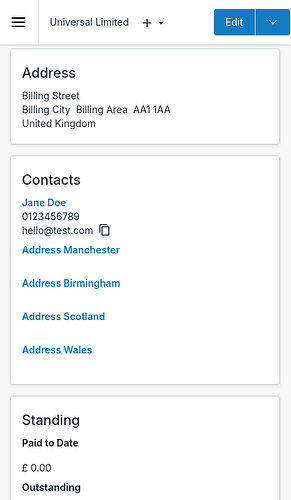

Then added the details to the client contact:

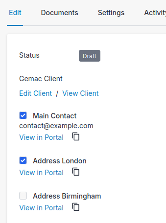

Ticked the contact checkbox when creating an invoice:

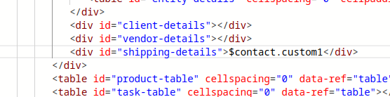

Created a custom invoice layout with the custom field:

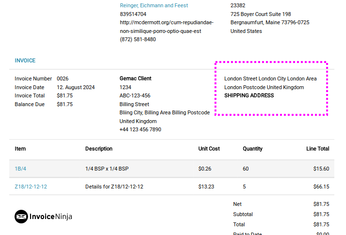

But the layout looks wrong:
I would expect the text SHIPPING ADDRESS at the top and the multi-line text below with line feeds respected. Is there a way to edit that?
