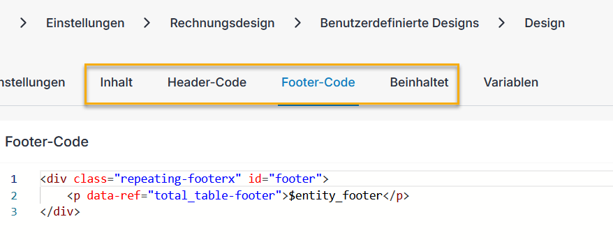

hi, how can I see the html code of the clean design? I can see it of my copy, but not of the original. As I understand you ask, whether I can see here a difference?
When editing the design the code is split between the body, header, footer and includes tabs.
hm, yes, but my question was: Can I see somewhere the code of the Clean design?

I am now comparing the default html code with the copy of the design.
However, first I compared the clean.html file on github (your link above) and the one on my custom installation, which I did not touch. Interestingly there is one line slightly different, I wonder how this is possible?
grafik
And here the differences between the original clean file and the custom (copied inside ninja invoice)
this piece of code is in the original file but not in one of the 4 code fields of the custom template
$status_logo
And this line is also missing in the copy
$entity_images
I compared html code in these 4 fields with the original file
however, why public notes are not shown is not clear to me.
