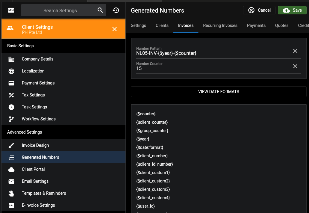

Thanks for the reply. Yes, I roughly know it. However, I can’t seem to make it work.
Client level
But when I generate a new invoice. It took the client level settings but took the company level counter.
So instead of NL05-INV-2025-0015, it generated NL05-INV-2025-006.
Any pointers would be appreciated.
Thanks in advance.

Understood, I think you want to change $counter to $client_counter.
Hi @hillel,
Thanks! That works!
I filled up the ID Number field with “NL05” in the Client’s page and use the following string in the Client’s customised setting:
{$client_id_number}-INV-{$client_counter}
It is now using the Number Counter in the client’s setting.
Thank you very much!
