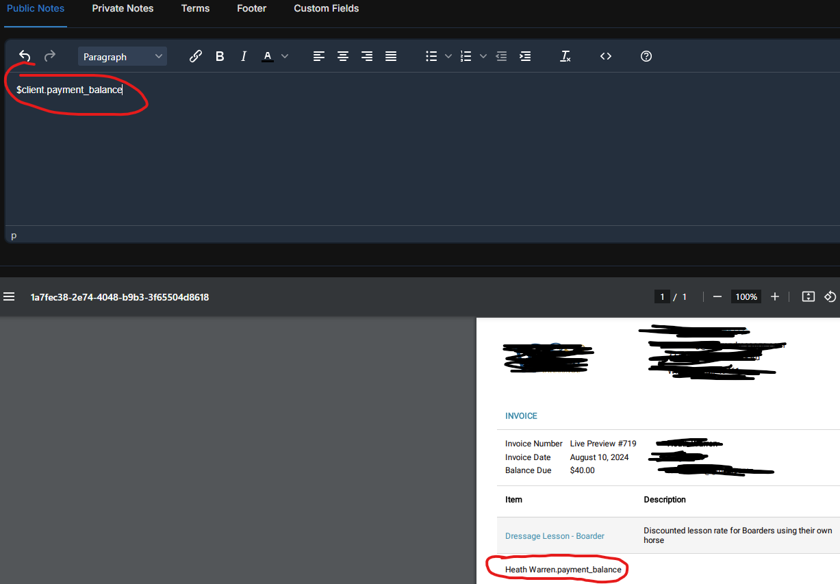

I am working both angles here forums and github trying to make some headway. It seems the variable was exposed but David mentions it is only available for use or in public notes or custom invoices. I tested using in a public note but it did not result in displaying a dollar amount with multiple unapplied payments on a test client invoice. I tested a full invoice including sending and the PDF in the email just read: client name.payment_balance. Honestly putting this as a public note on every invoice is just more workflow steps and not what I had hoped for.
