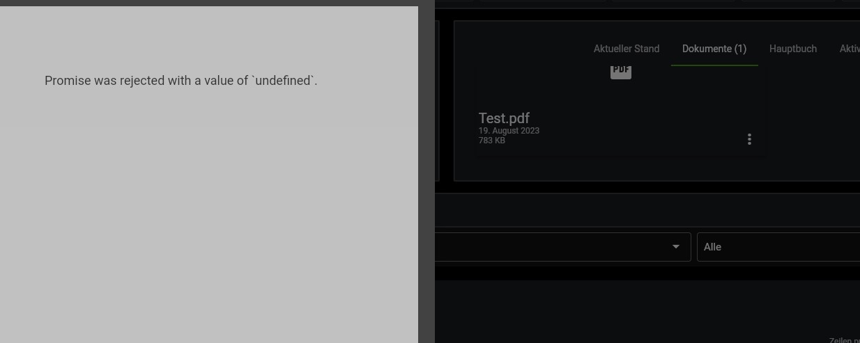

I tried to upload a pdf to a client. This seems to work but I can´t show it:
Also if I download it is 0byte:
Screenshot 2_3
but the upload shows 783kB in the picture above

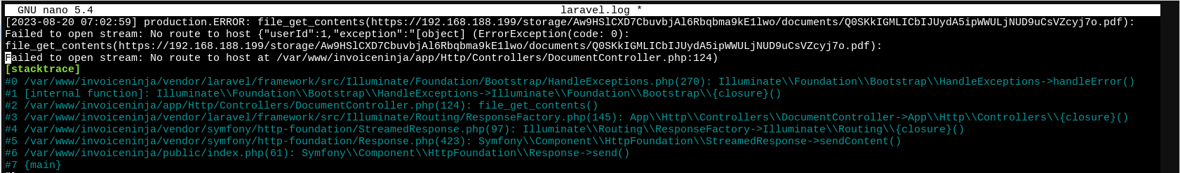

Are there any errors in storage/logs when the download fails in the Flutter app?
Thanks! I think I see the issue, we’ll work to correct it.
