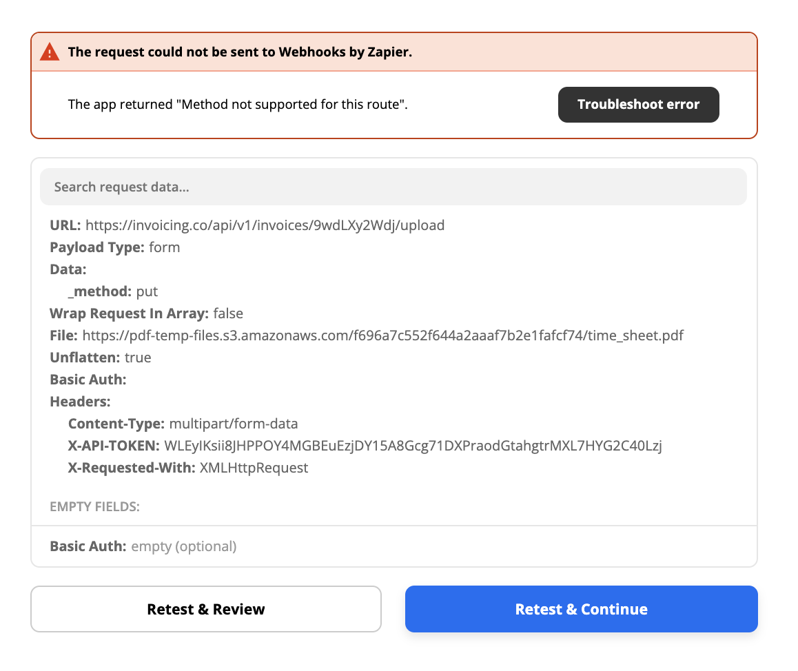

Can you please just tell me what I’m missing here? I keep getting the same error “Method not supported for this route”
I suggest first getting the request working using the cURL sample above and then trying to port it to Zapier.

I kept all the steps consistent and instead tried it in a put step and got a new, more hopeful error. Problem is that I do have a paid plan.
"The app returned “Upgrade to a paid plan for this feature.”
Uploading documents requires an enterprise plan.

Comparing the screenshot above to the cURL request I see some differences, for example the app is expecting the file index to be documents[]. Also, cURL is sending a POST request with a _method=PUT parameter.
I don’t know that you can indicate a method within a method in Zapier. Is there any examples anywhere of this being done outside of Curl?
Is there any way to create a native integration within zapier for this? This one little step is holding our entire company back from moving to v5. There has GOT to be a way to do this.
In the screenshot I see method:put, it should be _method:put.

I got the request itself to work with adding method _put, but it’s not liking the file being passed along as a url. How can I get this to accommodate a url as the file?
