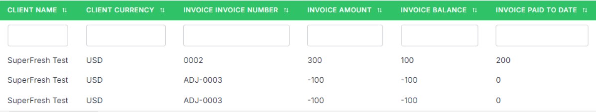

We had a client who paid $300, and then requested a refund of $100. We refunded through IN, and then created a negative adjustment invoice of -$100 to get the account in balance. That all worked well.
But the Invoice Item Report shows the negative invoice (ADJ-0003) twice. I recreated this scenario in our test company, with the same result.

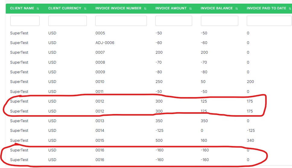

  • But: Ran INVOICE ITEM Report, and a duplicate copy of the ADJ invoice shows up, see the screenshot in my original post (ADJ-0003 is listed twice).

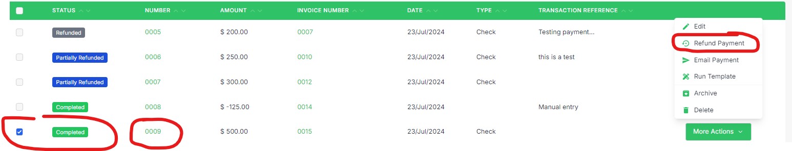

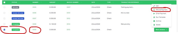

OK, I think I may have isolated the problem. The behavior seems to be associated with an invoice related to, or created immediately after, a partial refund that is created using the MORE ACTIONS menu, as opposed to using the REFUNDS tab on the payment itself. The refunded invoice, OR the next invoice created, shows up in duplicate on the INVOICE ITEM report. Here’s my testing - perhaps this will help you to duplicate it. The common denominator appears to be the way the refund was created. In the first instance, the refunded invoice itself appeared in duplicate, and in the second instance, it was the invoice created immediately after the refund that appeared in duplicate. When I repeated the test, but edited the payment itself to create the refund, there was no problem.
Here’s the reporting, with the incorrect entries circled, and below is documentation of my testing.
I hope this will be helpful to you.

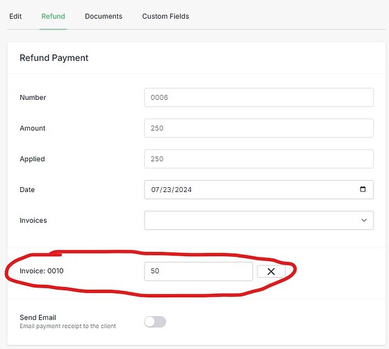

Created PARTIAL refund by going into the payment detail, selecting the refund tab on the payment 0006, selecting invoice 010, and editing the amount in the bottom field to be $50.

Created PARTIAL refund by going to the MORE ACTIONS menu, and selecting refunds, on the payment 0007, selecting invoice 0012, and editing the amount in the bottom field to be $125.

Invoice ITEM report is reporting INCORRECTLY. It is reporting Invoice #0012 in duplicate.

Created PARTIAL refund by going to the MORE ACTIONS menu, and selecting refund payment, on the payment 0009, selecting invoice 0015, and editing the refund amount in the bottom field to be $160.

Invoice ITEM report is reporting INCORRECTLY. It is reporting Invoice #0016 in duplicate.

Created PARTIAL refund by going into the payment detail, selecting the refund tab on the payment 0010, selecting invoice 0017, and editing the amount in the bottom field to be $200.
Invoice balance is now $200.

I am still unable to recreate this. as it is an invoice item report, it will have each line item of the invoice, can you compare the item notes/product/unitcost/quantity for any differences there.

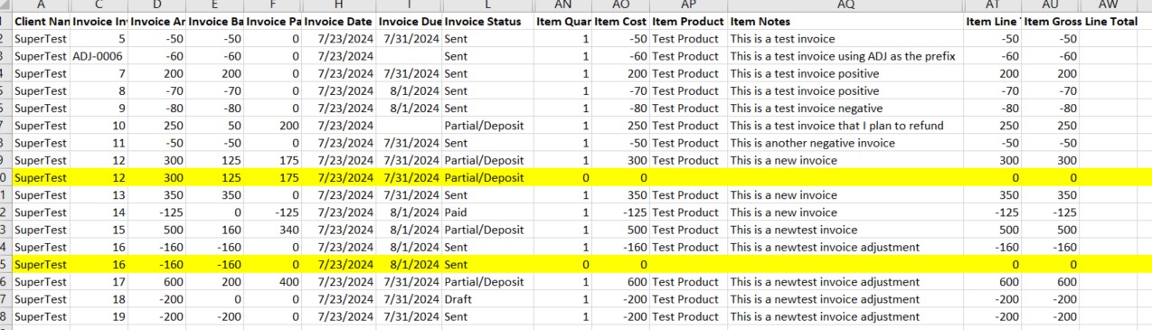

Here’s the Invoice Item report - I’ve hidden columns that aren’t important and highlighted the two “duplicate” rows.
InvoiceItemReportForIN.csv (3.9 KB)
@debored
Thanks, this is helpful. So it appears that each of these invoices has a second line item with a Zero Quantity?
This would explain why you are seeing the doubled up lines. The next question would be, what - exactly - is causing the additional lines to be inserted. If you can pinpoint where the additional line is being added we can localize the issue, from my initial tests again, I’m still unable to recreate.
When I broke down my process and tested each part that I thought might be causing this, it seems to have something to do with creating a partial refund using the MORE ACTIONS menu. In my testing, I ran the Invoice Item report after each step, and the duplicate entries ocurred after that action was taken.
