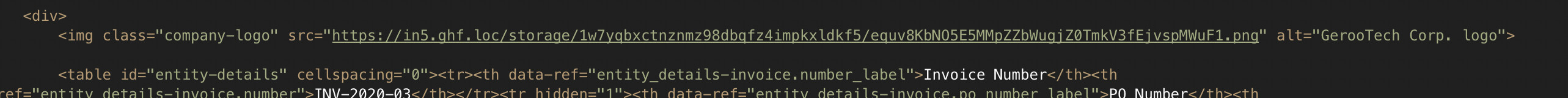

Hi David,
Here you are the .env
        <table id="entity-details" cellspacing="0"><tr><th data-ref="entity_details-invoice.number_label">Invoice Number</th><th
I can access this image location from my browser.
Note: when i pasted the line it already downloaded the logo to the post
When i saved the log output to html file i was able to view the invoice with the logo.
